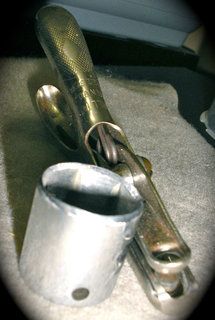

Take a "Cheap" 22mm 12=Point Socket and Sharpen the opening with a Bench Grinder and a Dremel.
Grind the open end to a razor-sharp cutting edge.
Use it as a Cookie Cutter to carve curved openings in Gasket Making Material.
A "Single-Hole Paper Punch" makes small holes easily.
Sight the Hole Punch's I-D on the Bolt Hole Mark.
3 or 4 clips and you have a clean-cut Bolt Hole.
