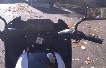

    Modifications & Accessories:
    Frame fully sandblasted and powder coated
    SS Brake Lines
    K & N Pods
    Mac 4 into 2 Exhaust
    Carbs jetted and balanced
    Dyna Performance coils
    Fuse box upgrade
    Progressive 430 rear shocks
    Vetter Quick Silver Fairing
    Shinko 712 Tires
    Stainless engine bolt set
    KG Rear carrrier
    and so much more I can't remember everything

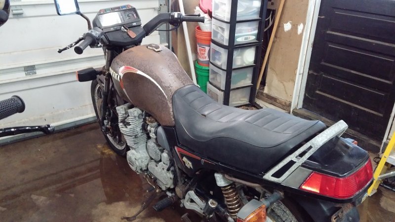

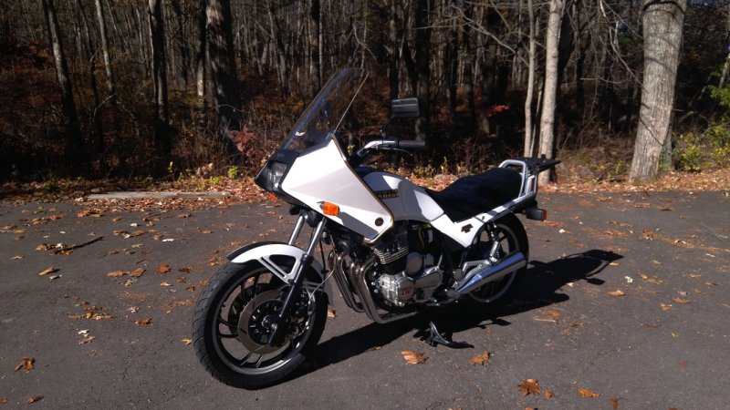

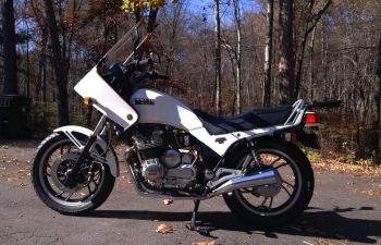

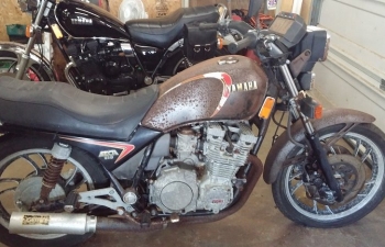

    Purchased this 1982 XJ750 Seca from original owner who neglected the bike it was a big POS when I got it for $250 with title will upload pictures of fully restored bike. After working on that POS for 3 years (We called him Rusty) here is the results. Mostly every thing came from the bike except - Gas tank, front fender and carbs, mice destroyed the originals. Love this bike.
ElkHavenSeca, RobPryce, wgul and 4 others like this.
  1. Retromoto
    Very nice. I like how you wrapped the carb bowl tubes up above so that you can always see what your float level is. Brilliant!
  2. cgutz
    Nice looking. Love the white!
  3. wgul
    She came out beautiful. Great job!

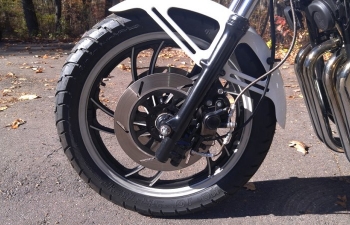

    Were can I find the front master cylinder for the brakes every company I called doesn't carry it for the 1981 750. I was told that mine burnt up and to get a new one or a rebuild kit for the old one.
    1. metricman820
      Hi Justin,
      You can get the rebuild kits from Chacal, here on this site.
      HCP23098 Aftermarket MASTER CYLINDER BASIC REBUILD KIT for all XJ750 Seca .$ 89.95
      HCP23155 Aftermarket MASTER CYLINDER FULL REBUILD KIT for all XJ750 Seca $ 119.95
      HCP11150 Aftermarket master cylinder-to-fluid reservoir rubber BUSHING, $ 16.95
      HCP11149 Aftermarket fluid reservoir FILLER SCREW, plastic hex-drive screw with o-ring. Fits all XJ750 Seca and XJ750 Euro models.$ 17.95
      metricman820, Jul 27, 2017

  7. Blahrny
    I love that fairing, mine has one too! Does your headlight point at the sky when the fairing is mounted flush with the brackets? I have to keep mine jacked up about an inch in the back.
    1. metricman820
      Yes it did, I trimmed the front plastic trim to be able to adjust the light to angle down.
      metricman820, May 12, 2017

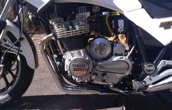

    Thanks. Can you send me the model # of the K&N pods. I may order a set.
    1. metricman820
      K&N RC-1824 Air Filters - K&N RC-1820DK Air Filter Wrap and for the jets - Dynojet kit - 750 cc Yamaha 81-82 XJ750 ALL MODELS Stage 1 & 3 - 4102. The K&N filters are pricy but keep them clean they should last for a very long time. I also put the wraps on them to help with dirt and rain.
      metricman820, Apr 5, 2017
  9. Jasonh
    How do you like the K&N intakes ? I've been told to stay with stock intake box or risk constant carb rejetting issues.
    1. metricman820
      I love the K&N pods, It did take me awhile to get them jetted just right, but have not had any issues with them. In fact my Seca starts better than my XJ650 Maxim which is all stock. Hit me up if you have any question on them.
