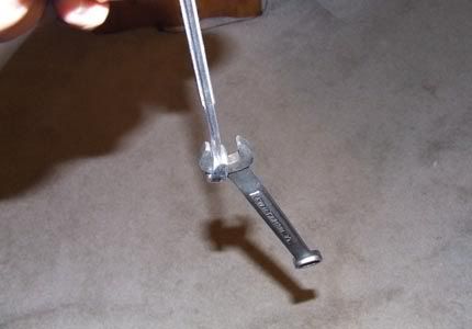

    So I started to take off my rear wheel tonight to check the rear brake. I removed the tension bar and the brake rod. Seemed simple enough. Went to the other side to loosen the axle nut. Then found out I don't have the proper size wrench or socket to loosen it. What size is this nut? I'm thinking 20mm since the 19mm seemed just a hair smaller. I need some half inch drive sockets for my ft/lb torque wrench anyway so I'll try to get some tomorrow.
  19. jazzaero
    jazzaero Member
    32
    Boulder, CO
    Removing the cotter pin on the tension bar.
    Removing the tension bar nut.
    Removing the brake rod adjuster.
    Removing the cotter pin on the axle nut.
