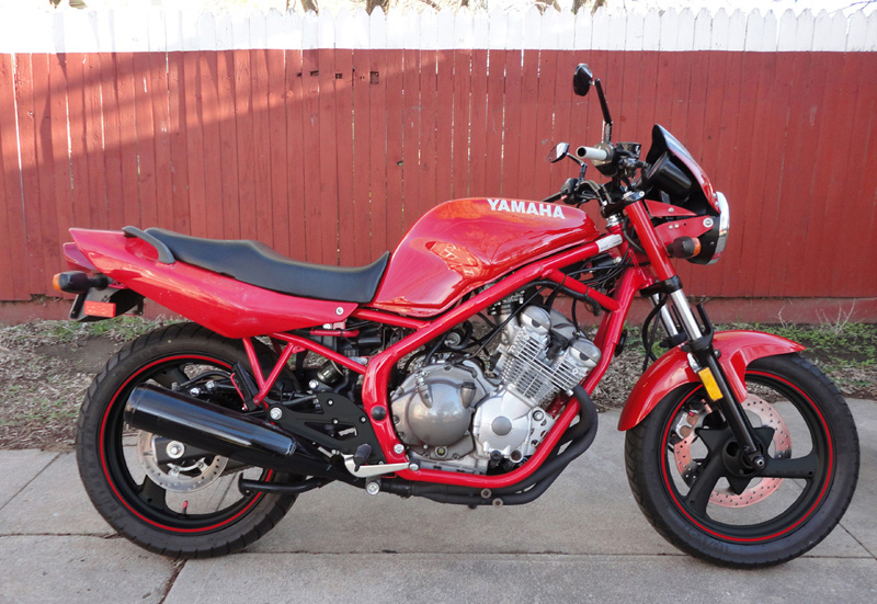

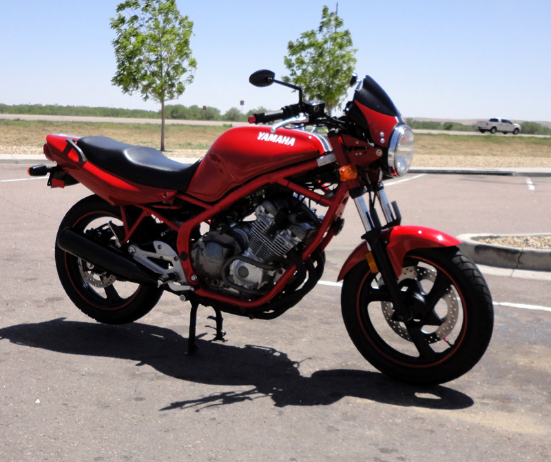

    I sourced a new tank, painted all the body plastics and decided to do a front end conversion as the original fairings were cracked and poorly repaired. Here's the result:

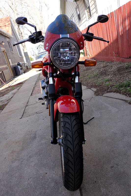

    The Specifics:
    The headlamp ears are made from 16 GA steel welded to 1 1/2" EMT Conduit. They slip over the forks and a 1.5" ID o-ring is used to seperate them from the upper and lower triples.
    The headlamp is a Delkevic 7" H4 from EBay.
    The small fairing is from a 2nd generation SV650N.
    The gauges are Trail Tech vapor.
    The handlebars are the European bend from BikeMaster (EBay), in black.
    I used stock triples, stock cables and stock brake hose.

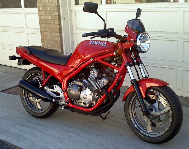

    Better sideview picture. I need to tilt the headlamp fairing back forward; it's rolled backward to give me access to the headlight and its wiring and I forgot to roll it forward. Should lip over the front of the headlamp slightly.

    Very nice looking mods! It looks like you have removed 15 years of style from the bike! Looks 2000 or later model year. Your gonna LOVE that H4, especially if you convert it to HID. $25 from DDM Tuning, an easy install and so worth it!

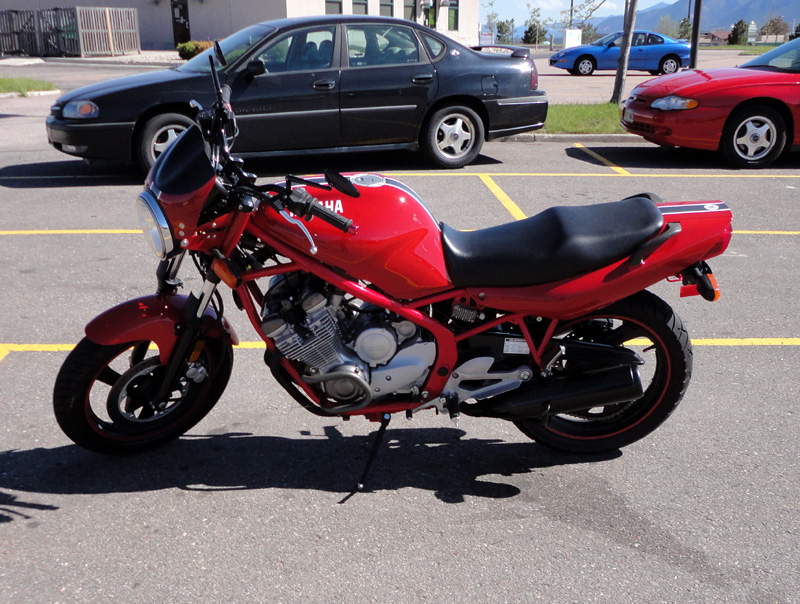

    Thanks for the Kudo's! The speedometer sensor is the generic hall-effect type with the magnet on the front wheel. I mounted it to the fork leg and routed the wiring through a hole I drilled in the front fender. I'll try and take a picture tomorrow.
    I received my stock seat today and fitted; much better look in my opinion. I'm going to leave my SV650 in the garage tomorrow and take the Seca to work to see how it does. I'll get a nice picture when I get there showing the progress.

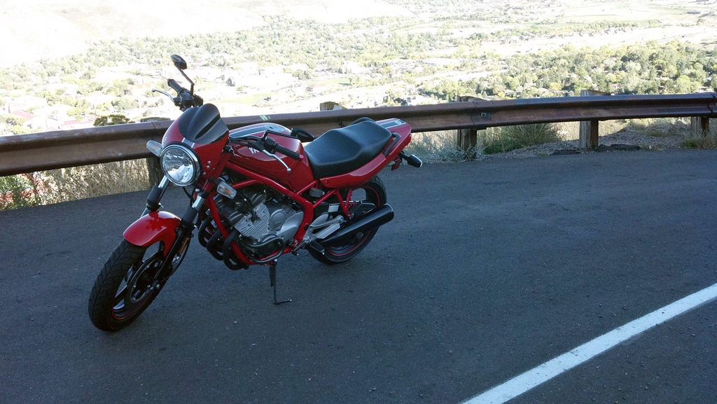

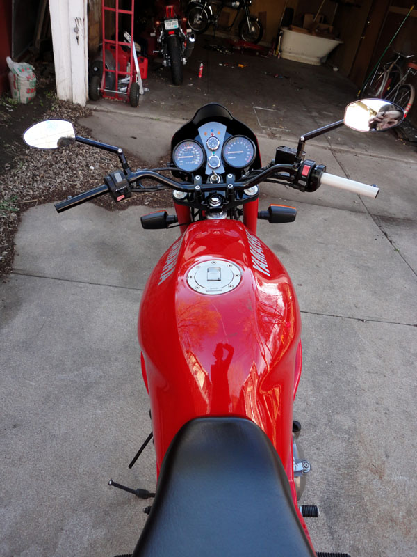

    Pictures from amidst today's ride. Took her up through Coal Creek canyon and into Central City. She did great. I'm running a set of Kenda Cruisers and I'm quite impressed, bang-for-your-buck wise.
    Here she is with the stock seat:

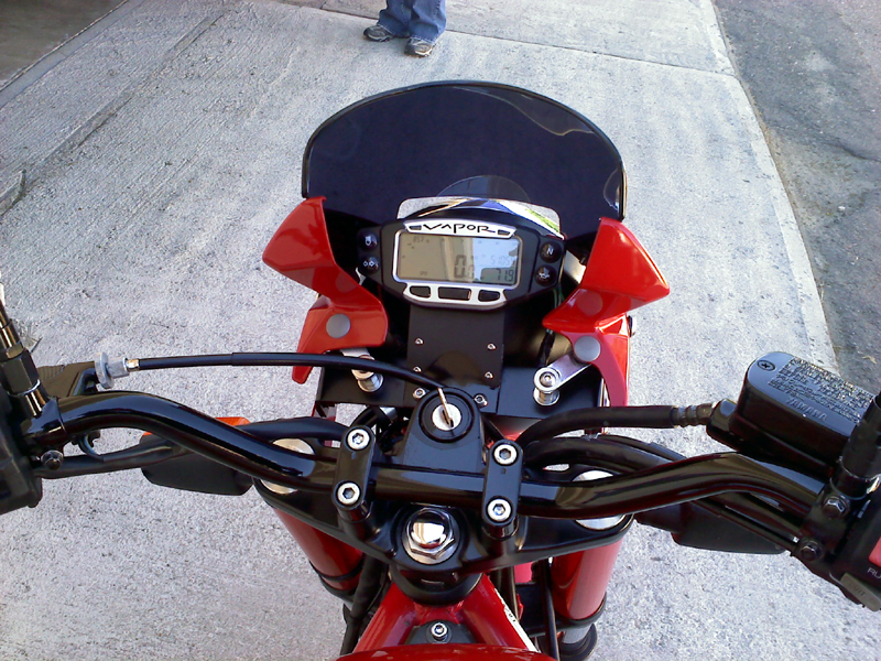

    And a view of the cockpit:

    I like the gauge man. It fits behind that mini fairing nicely.

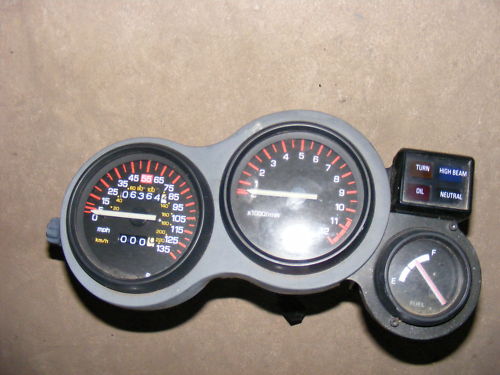

    I decided to give up on the Vapor gauges as the tachometer was just never as good as I needed it to be. It worked well at lower RPM's but would get really erattic at higher RPM's (when I needed it most).

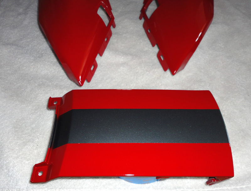

    I started by converting a set of FZR600 gauges and ended up redoing the paint and tail. Here she is, test assembled, before paint:
    And here are the pieces, painted and cleared in lacquer, waiting for the 2k final clear coat. Once the rain stops, I'll get the stripes finished, the decals fixed and the clear shot. When done, the tank and tail will have a white strip to match the Holeshot fairing:
