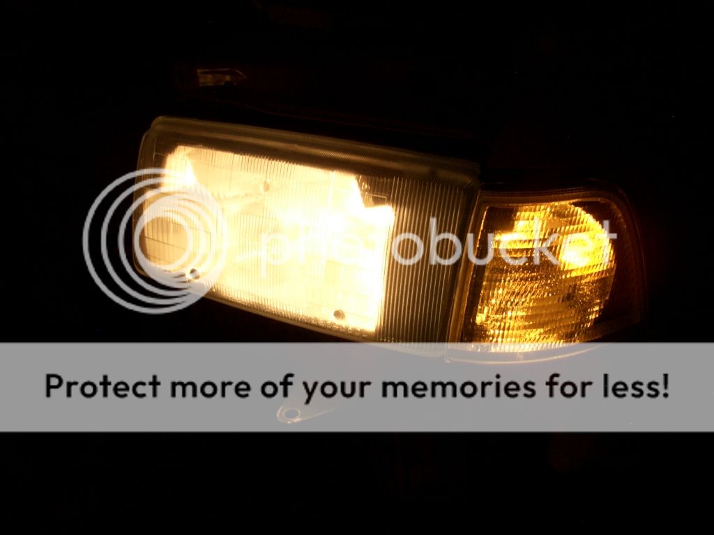

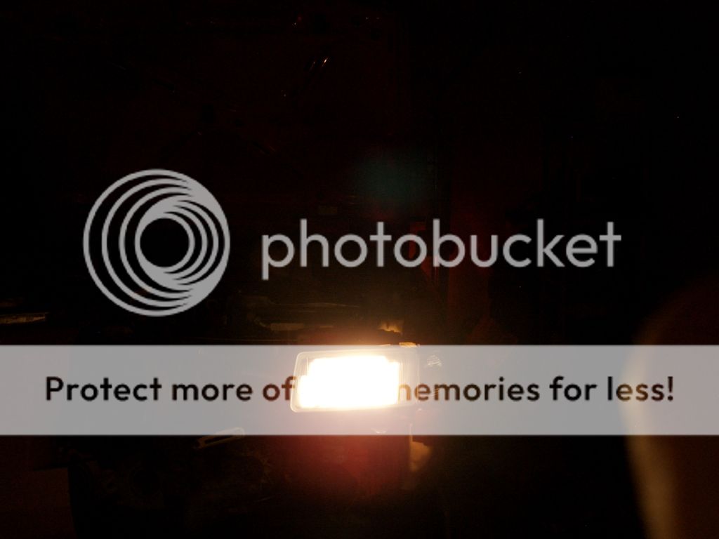

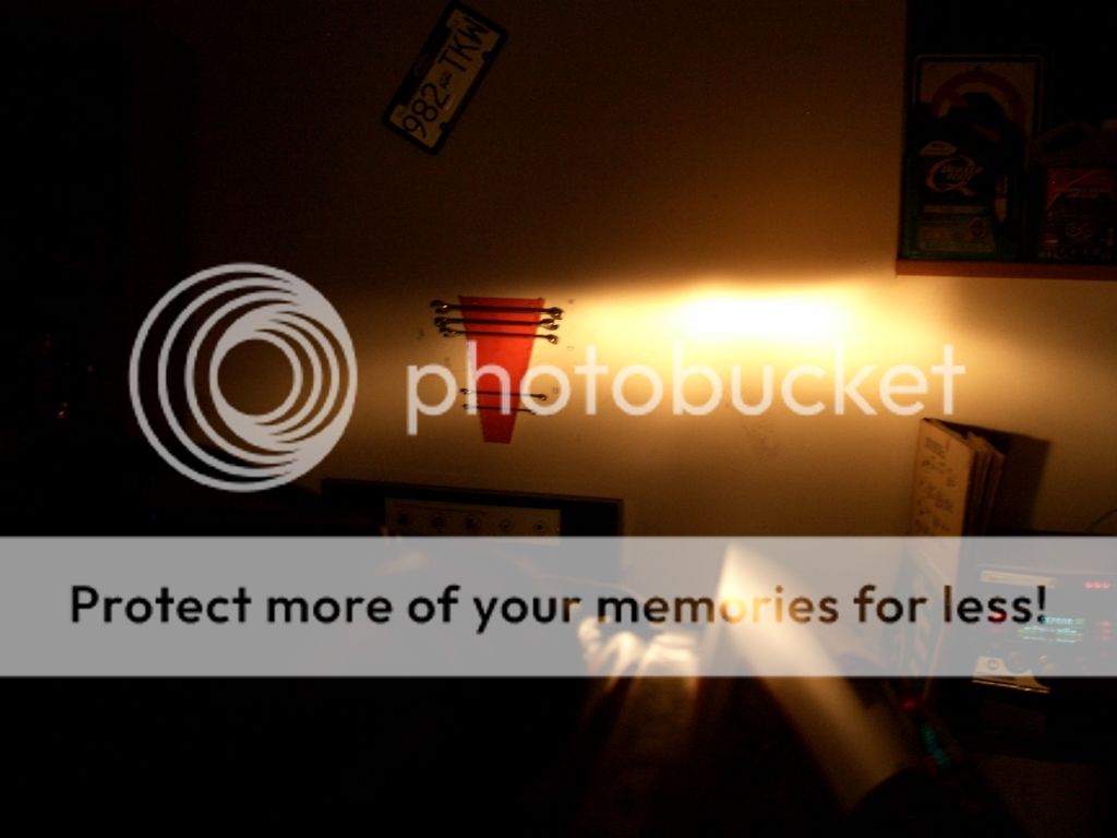

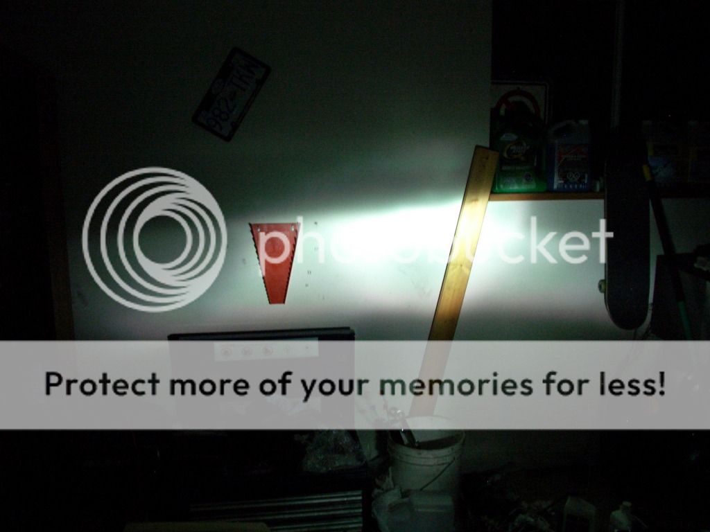

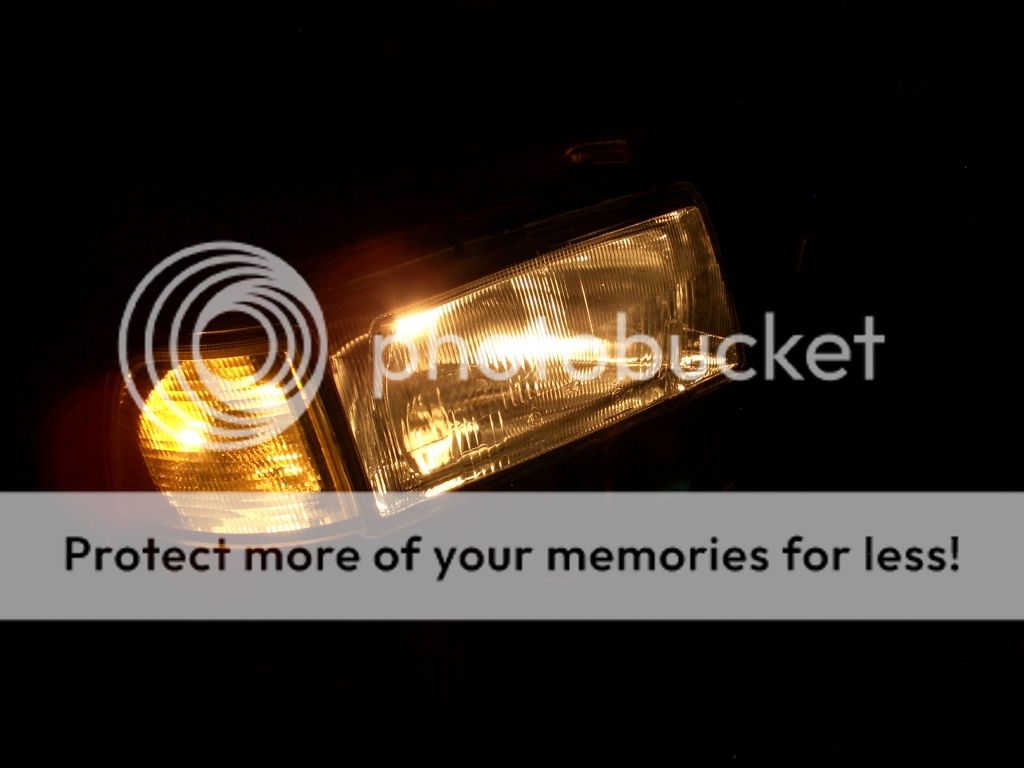

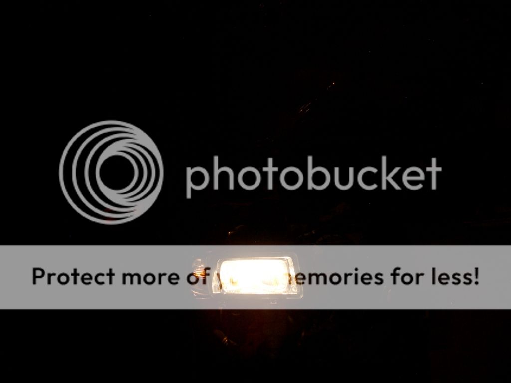

    So these follow pictures are to replicate the average driver's amount of glare. Each pair are taken with the exact same camera settings (focus, shutter speed, ap, blah blah)
    I used a wooden stick i had that was at the perfect height to imitate the location of where a average driver's eyes would be. Obviously raised trucks and slammed civics are gonna be an exception.
    Same bulbs - Showing the beam patterns and glare on the wall.
    DOT (trust me, that is NOT the high beam. I tripple checked. The highbeam lights up the entire wall rather than a hot spot)
    E-code
    Side glare
    Obviously a DOT
    Heres an E-code
    Looking at it from driver's angle
    Dot
    And E-code! See the difference?
    Now e-code with HID installed.
    --> THESE ARE *55 WATTS*!!!! 6000k H4's<---
    Most hid kits are only 35watts. I got them because I do offroading/rallying with my audi in the forrests at night. Kinda nice to have brighter lights so I don't hit a deer in the middle of buttf**k nowhere....
    So with 35W hid kit's you'd have even less glare!
    Notice how you STill can't see my license plate on the wall
