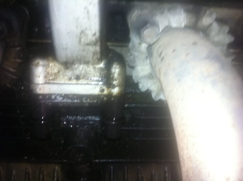

    OK, I have a major oil leak at first I though I some how mangled my valve gasket and I did a little, however this has been a lot of oil. So, today when I got home I let the bike run and I wiped the front of the motor clean and watched with a flash light it appears that in the front of the motor, about half way down in the front that seems to be where the bulk of the leak is, I can see oil seeping out wiped it away and it re-appeared in seconds. So, I am guessing I am pulling the motor and replacing this gasket is there anyone in the Richmond, metro area that can help. I don't have a garage and I really need some where to work and maybe some experienced hands and eyes to help out... I am trying to figure out how this gasket went... Maybe it was just its time. But this looks like major work from looking at the service manual. Or is this one of those things you say time for a new motor? Help me out guys.
    Below is the area where I saw the most oil seeping, however, there was fresh oil coming from the valve cover so maybe *hoping* it was just running down to there and I didn't see it running because of the poor lighting and all the black baked on oil...

    OK I am wrong it is coming form the valve gasket, It is leaking down I cleaned it up a wet rag and then watched it and noitced it was running down not coming out of this area.. whew....

    Yes, relief. Replacing a base gasket is a PINA. Replacing a valve cover gasket is much easier, don't forget to replace the cam end plugs and check the valve clearences.

    By "cam end plugs" he's talking about the half-moons we discussed. (I answered your PM.) On the YICS motors they're part of the silly gasket. (On the non-YICS motors they're separate plugs.)
    The gasket you thought was leaking would have been the head gasket; the base gasket is further down, at the "base" of the cylinders.
    BTW, when you eventually think you have a base gasket leak, replace the cam chain tensioner body-to-cylinder gasket and the o-ring on the tensioner bolt. When (not if, when) that starts leaking it will "migrate" all around and convince you that you have a base gasket leak. Guess how I know this?

    If the 650s are the same as the 550s maybe you caught the inner lip on the upper front camchain tensioner mounting thingie/bolt.
    When you have the valve cover off, be sure the "fake" cam caps (the ones that are only there to hold the cover) aren't loose or cracked. Not unheard of either.
