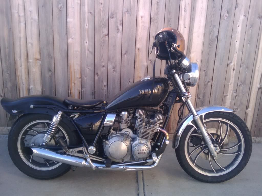

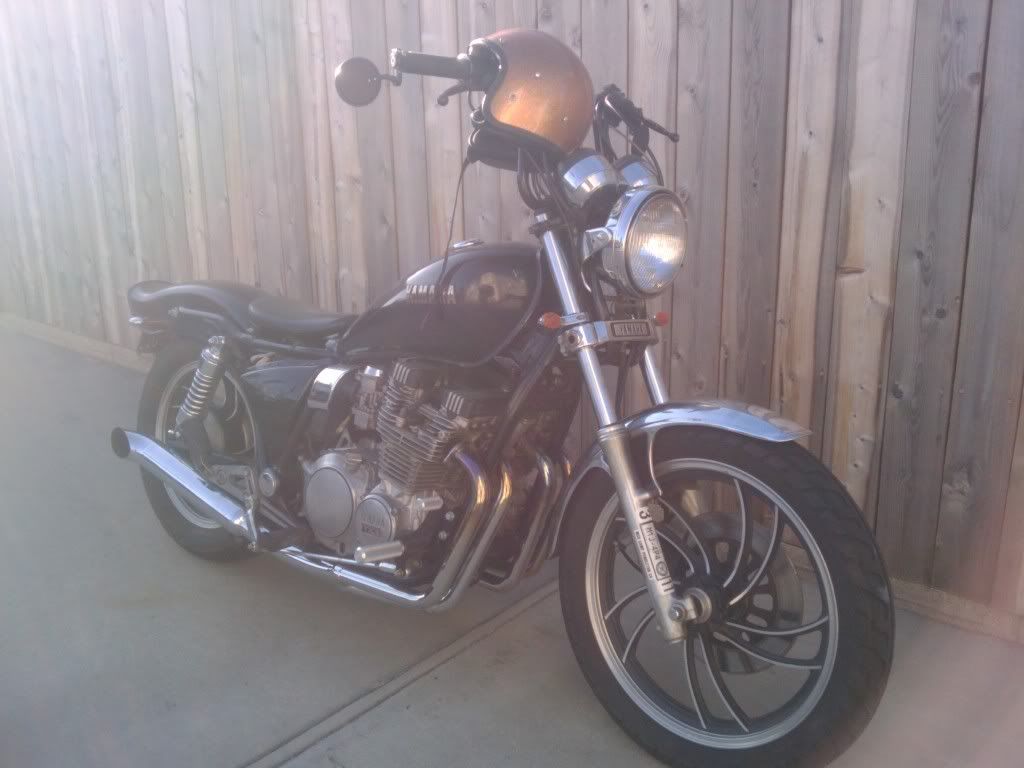

    Not quite "finished", but she's a daily driver

    I need to ditch the front fender and center stand. I just installed the TC Bros forward controls, gotta work out a few bugs. Got a mini speedo to replace the stock unit but still waiting on the mini tach to arrive. Then strip, shave & paint the tins. I have a spare swingarm/driveshaft assembly that another forum member will be stretching 3" which should drop the rear another 1-1/2 to 2" without risk of the shaft binding. I'll need to redo the rear fender, probably mount it to the swingarm. I may lower the front end to even it out after the stretch. Still working out the details.
    She was completely stock and ran beautifully when I picked her up for next to nothing; threw the Mac 4-2 on and she sounds more like the beast she is while still being mechanically sound. No reason for me to mess with pods.
