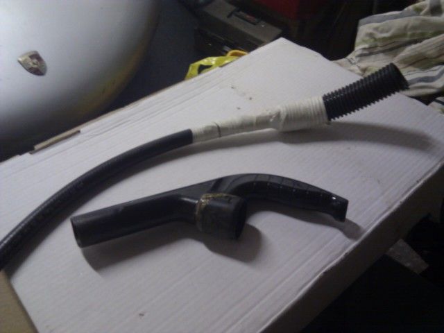

  17. Rice_Burnarr
    Rice_Burnarr Member
    424
    Near Philadelphia, PA
    Haha! Well you started it! :lol:
    On the serious side... If you haven't run the motor yet, I'd take a piece of tubing just small enough to fit down the spark plug hole and tape it to the hose on my shop-vac. Stick the hose down the spark plug hole and go fishing.
    You can swing it around a bunch down inside the cylinder and try to pull out anything that may have gone down there.
    Might not even catch anything, but would give me piece of mind.
  18. Rsk_141
    Rsk_141 Member
    87
    Scotland
    Yeah think it all sorted, thanks for the reassurances
    Built Vacuum tool
    Waiting for Shims so not tested but sure it will be OK.
