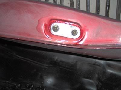

    For the blocking of the petcock, I just cut out a piece of sheetmetal, rounded it off on the edges, drilled some holes and sealed it up with some liquid electric tape (just in case there was some gas left in the motor - and because i knew it would be easy to take off...).
