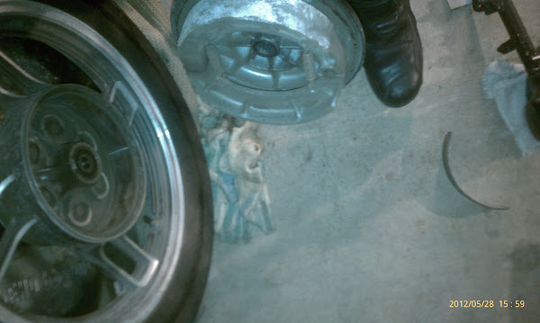

    Well I've made some progress the last two weekends. I soaked all of the exhaust hardware in kroil (except for a bolt or two that I couldn't see) and let it sit for a week. Every bolt that I soaked came off with ease. I used a wrench and hammer as an impact driver, but everything came off without incident.
    I pulled the turbo and all of it's oil lines, and I didn't see ANY oil leaking from ANYWHERE. So that's a bit of a mystery that I'm going to have to solve, but it doesn't look like it's leaked out of any valves to the turbo.
    The turbo and compressor impellers seem to spin smoothly without any play or resistance, but I don't know much about turbos. JeffK, maybe I can stop by with the turbo and you can tell me what you think of its condition. 18psi boost is mighty tempting.
    I decided that since the bike has only 6k miles on it, and blows good compression, I'll go ahead and do it up nice. I've purchased a cheap propane heater for the garage and I'll get some lights and an extension cord, and paint this winter. We'll see if the little heater can keep the cold at bay, especially since it's an outdoor heater, I'll have to keep the door open. First test of my setup is going to be the headers and mufflers, and the little ducty things on top of the valve cover.
    And speaking of exhaust, there was this nasty, rusty, milkish substance at the bottom of the collector. Should I do anything to flush this stuff out?
    So I'm going to take it down to the frame, and repaint everything. Just going to stick with rattle cans, since I don't have power to run a compressor, and none of the paint should be coming in contact with gasoline anyway. Halfway done pulling off the wiring harness and removed everything off the rear of the frame. I'll need to start taking more pics as I build it up.
