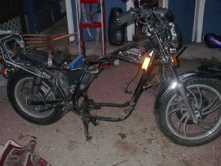

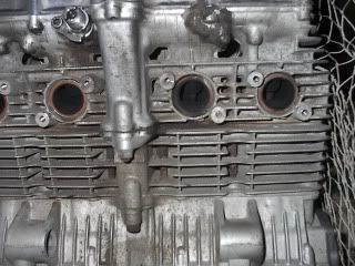

    It was actully a lot easier than I thought and the motor was lighter than I thougt. I was abel to pick it up and carry it and put it in the back of the truck with no assistance. I a m going to take it to my buddy who is a machinist and have him remove the stud that is broke off. I had 4 other bolts that were stuck in there but with a little patience was able to get them out as well. Thanks for the other advice Rick. I will look into it. I just got the bike road worthy after many years of waiting. So I will probley just get the stud removed and maybe a couple other things that can be taken care of while the motor is out. I just want to get to riding now. Here is a pic of the problem also. [​IMG] It is the stud on the bottom of the second port in pic. You may not be able to see it to well. My camera is not the greatest.
