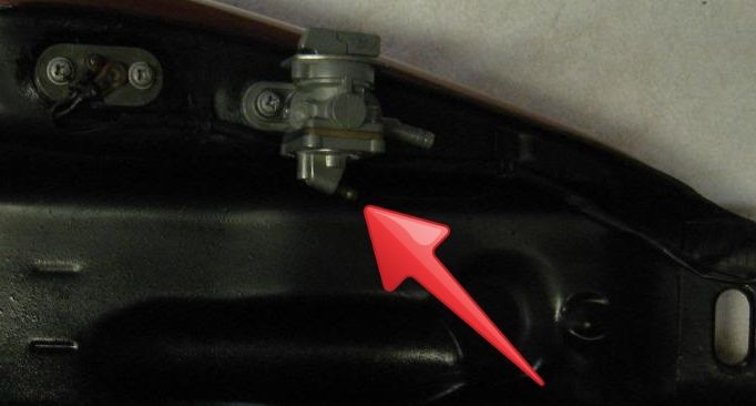

    Thanks for the reply's, can you tell me where the vacuum pipe connects to the bike from the Petcock, also the previous owner claims the carbs had new air inlet rubbers fitted and the carb's ultrasonically cleaned, my guess is, for them to do all that work, this was an ongoing problem for PO, what I cannot understand is why it would run before with petcock in the On position and now it won't, especially since it wasn't even connected to anything but a bolt stuffed in the end of vacuum pipe. The uneven running isn't a great issue as once its revved out of the low revs it seems OK but would be nice if it could be sorted, I'm wondering if the carbs need balancing or could it be something simple (Hopefully)
    Tony, unless its the angle I'm looking at it, the petcock on mine looks different to the one in your photo, please photos below, I'm guessing the 2nd photo showing the red blanked off outlet from carb body could be where the vacuum pipe should be connected

    First, that doesn't look like a stock petcock... it's been replaced.
    Second, the "vacuum pipe blanked off with a bolt"... I don't see a bolt, but it looks like a red cap of some sort. On the #2 carb, you say? You've got a California X... at least the carbs are.

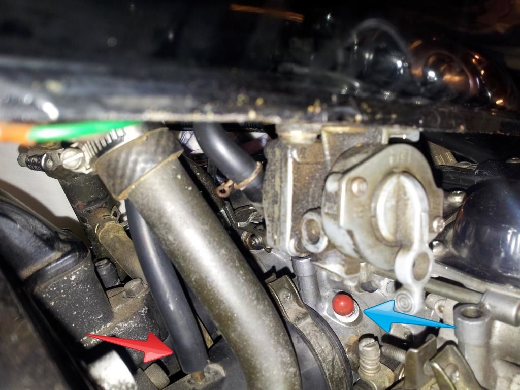

    Took the liberty of editing your picture:
    The vacuum line off the #2 intake (red arrow) is what is supposed to be connected to the petcock. Where does that go to, and is the end on that plugged if not connected to anything?
    Next, the petcock you have on there now is not original, and may or may not work in the on and reserve positions. You should do yourself a favor and get a replacement that matches the original if it doesn't work.
    Also curious to know if your bike is a California model? Does your serial # start out with JYA1LT00? The reason I ask is that the second (blue arrow) points to a vacuum signal fitting that is specific to the fuel vapor recovery system. The big issue is not that it is capped off, just that your fuel tank cap may not be vented and will not allow fuel to flow properly if that system has been disabled.

    All is becoming clearer for me now, this machine is a California Model as the number on the Frame starts with JYA1LT00, and when I've raised the tank up I can see my mistake, I've missed the vacuum pipe and left that dangling and put the vent pipe from the rear of the tank (which has been blanked off with a bolt in the end of pipe) onto the Vacuum point on the Petcock.

    Vacuum pipe now in its correct place
    Vent pipe from tank now in it correct place, this is blanked off with a bolt
