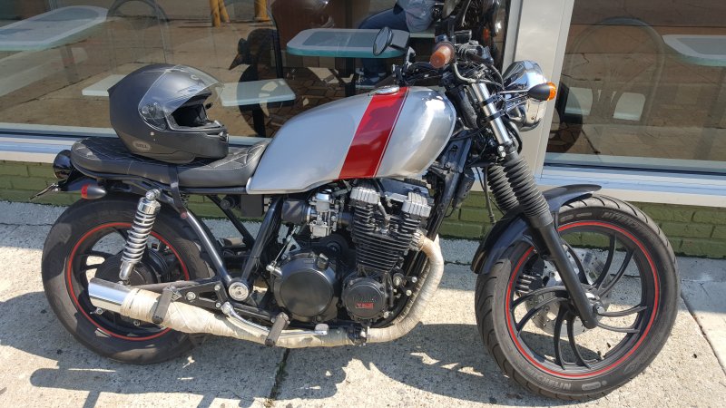

    The goal of the build was to create a custom xj650 tracker/brat bike.

  4. Dirty Harry
    That looks great! How hard was the 550 tank to put on? I have an 81 650 I'd like to do the same with.
    1. sybe
      It wasnt too hand. Some welding is needed. You have to widen the top neck of the tank by banging woodend down into the area that it grips the side mounts.
      One you have that fitting then carefully cut the welds on the cross member that the tanks bolts down to and move it back on the frame to aligne with the tank and then weld back on.
      sybe, Apr 25, 2016
    2. Dirty Harry
      Thank you! I'm am definitely going to do this!....if I can find a tank somewhere besides ebay ($300 for shipping, WTF?)
      Dirty Harry, Apr 25, 2016
    3. sybe
      I lucked out and found one on ebay for 150. It has a cheap paint job and part of the right side emblem is broken. To me its perfect.
      As long as the tank doesn't have any dents, and the inside isnt rusted then definitely jump on any you find. If it is rusted look into the electric derusting process (cant think of the proper name). It doesn't damage the metal and is safer. Once thats done, just seal the insides and you will never have to worry about it.
