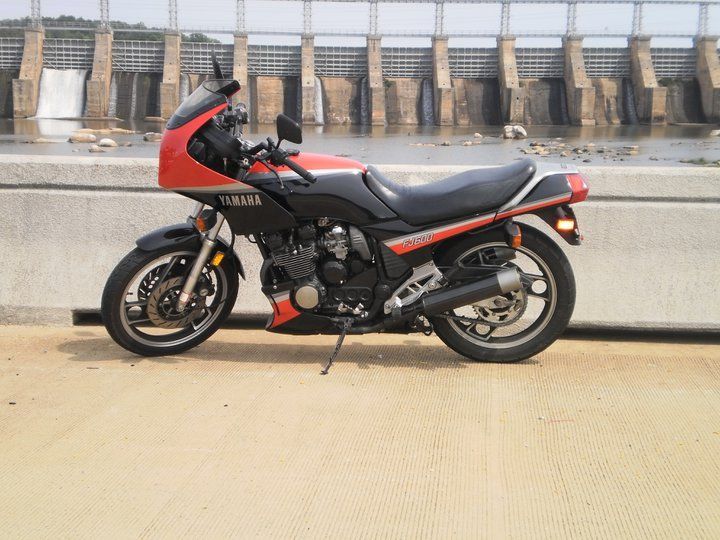

    She just did her FJ600 carbs the other day. The shop messed up and sent two #3 and two #4 manifolds, so we're waiting on that, then her FJ gets a valve adjustment and carb sync and she'll be back on the road this year.
