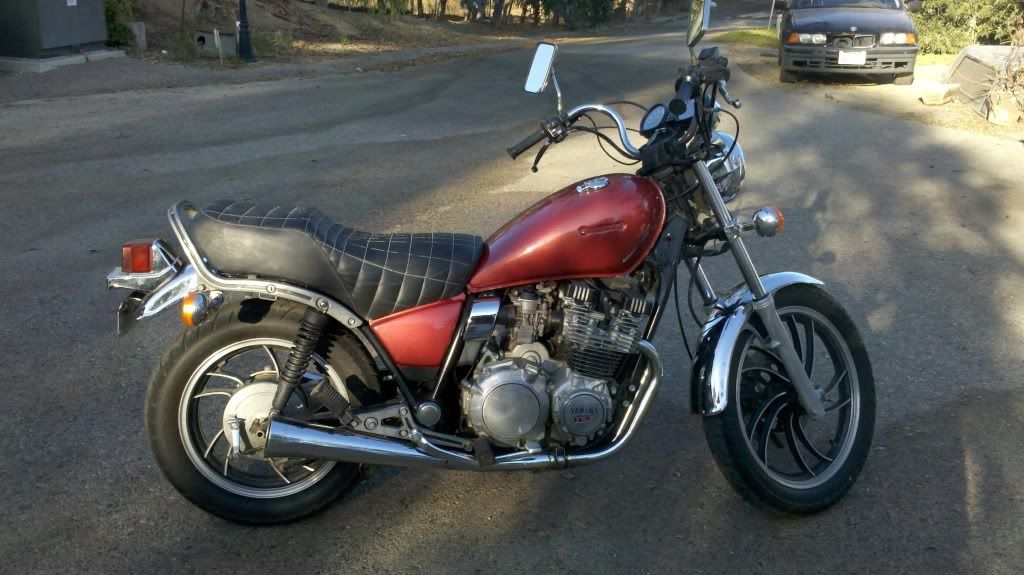

  25. AngryGnome
    AngryGnome Member
    98
    Moorpark, California (USA)
    agreed, please dont risk your life if you have access to a truck. just because the PO is riding it doesnt mean its safe! 800 is a decent price provided it has low mileage (like under 15k). i paid 850 for mine back in september with just over 9k miles looking like this:
    and a few months later (another $800-$1000 in work BEFORE i did anything that could be considered cosmetic. front and rear brakes inculding pads and lines, carb rebuild, petc*** rebuild, valves put back into spec, replaced many gaskets, replaced broken header studs) and then, only then, did i start on makin her beautiful. (paint, handlebars, flyscreen, highway pegs) and i'm still not finished! just thought i'd give you an idea of what youre in for. this is how she looks as of yesterday:

    Also, Angry Gnome - love your bike. That mini fairing looks great on it.

    "Also, Angry Gnome - love your bike. That mini fairing looks great on it. "
    Thanks! :)

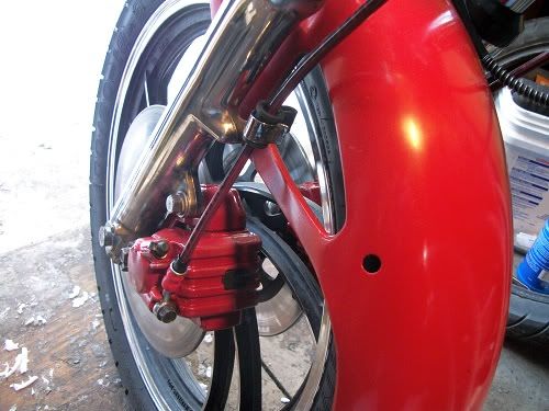

  38. tskaz
    tskaz Active Member
    1,878
    Saint Louis, Michigan
    You can see the black plastic cap on the outside of the caliper in this pic.
    You can pop that plastic piece off for a visual inspection of the pad thickness. The pads have a groove in the center of them. If you don't see that groove, the pads need replacing.

  42. tskaz
    tskaz Active Member
    1,878
    Yes, I should have been more specific. I was referring to wear on new pads, providing he had proof that the brakes were redone.
