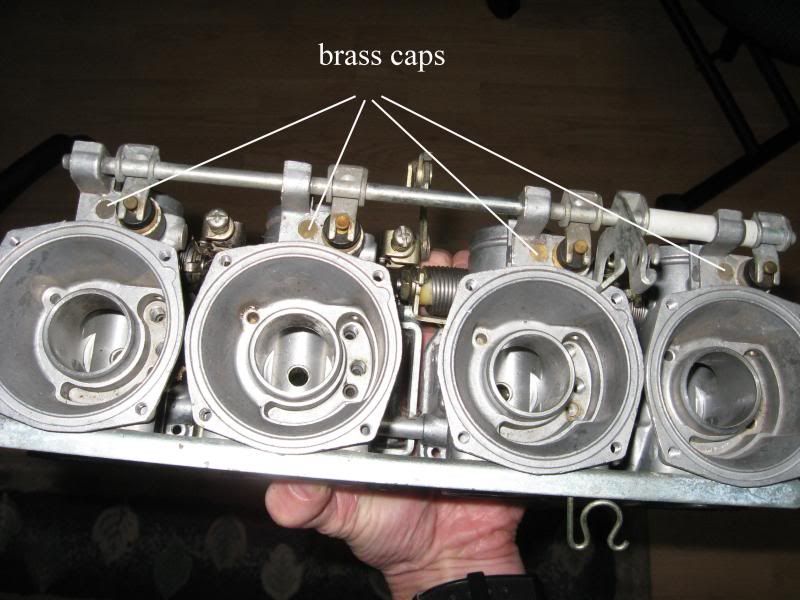

    -your mixture screws are too far out, 2 1/2 turns out is a good start, they are located here:
    They might be hidden under brass caps, though, then carefully drill these caps and remove them with an extractor.
