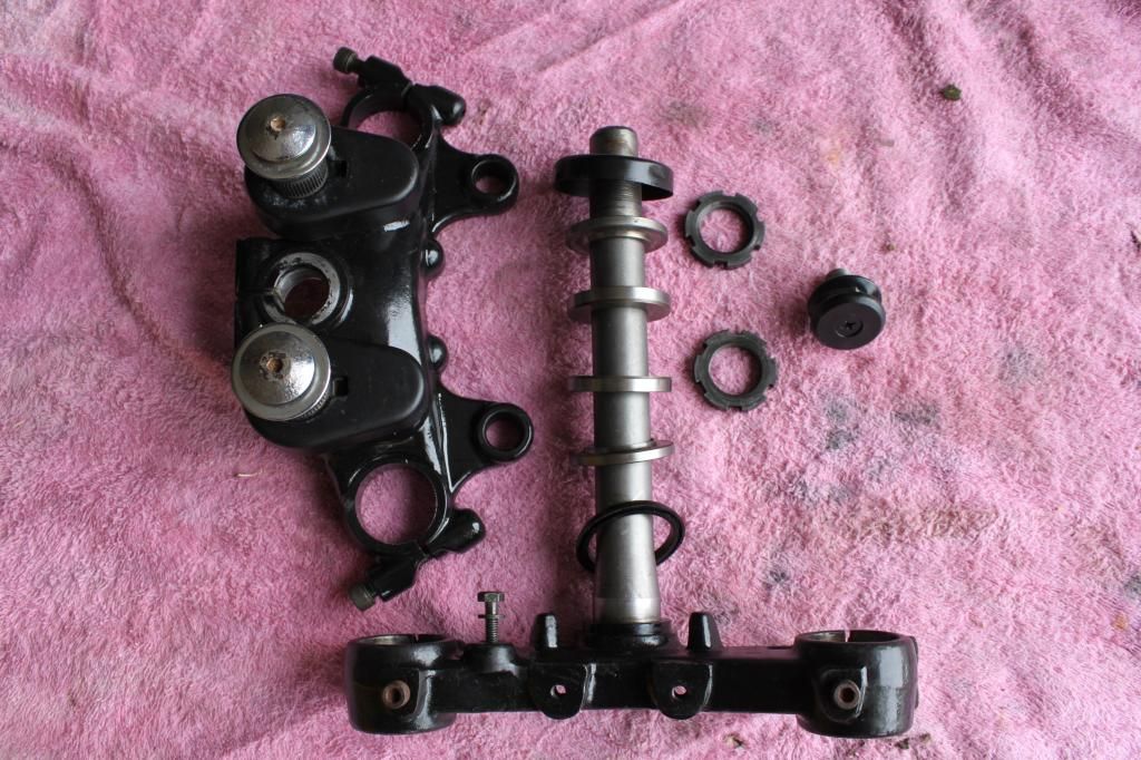

    Here is a pic of a triple tree on my 1982 XJ750J Maxim. Obviously, my balls have been removed...on the bike that is !!!!!
    You may have left on the the very lower steel race causing your problem as you mentioned....study the picture....
    It takes some work to get that lower race off.....be careful & do not ding up the tree....take your time.....

    If you have steel piece at the bottom of the shaft that has a concave lip around that balls could roll on, then yes.. The race is still there.

    Yep, the bottom race for the balls is still on. Didn't have time to even look at it last night, but yeah it's definitely the issue. I'll tackle it tomorrow morning.
