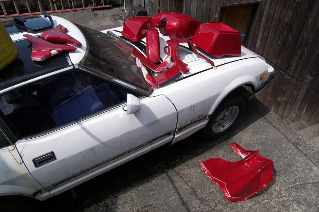

    One suggestion I have, with nice fresh new paint, is to leave the parts untouched for a week before assembly.
    Today's two-part paint is "cured" within hours and dry to handle. However, they are never really "hardened" that quickly. You can do a simple finger nail test to confirm this.
    When I had my panels painted, I resisted the temptation to assemble right away. I left them under the sun for a week while I work on other parts of the bike. Then sure enough, the paint could take a gentle finger nail scratch without showing at all.
    As for test assembly protection, I have use a couple layers of shrink wrap with good results. Shrink wrap allows me to see the position and mounting holes clearly.
