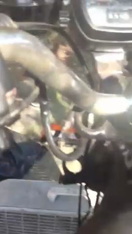

  41. aaron_acrusto
    aaron_acrusto Member
    195
    Pittsburgh, pa
    Ok so I just ran it a bit after work. It was acting up a bit, stumbled and died. I adjusted the idle speed and fired it up(warm no choke) and it holds an idle. Seems pretty responsive to the throttle. The plugs are looking better too. Maybe a little rich? I do need an air filter.
    I don't if this will work. Here is a video so you can hear how it sounds.
    http://i1243.photobucket.com/albums/gg5 ... d9eddc.mp4
  42. wizard
    Air filter is a must, unless you're running pods.
    Those plugs are ok, better than being too lean.

  44. KrS14
    KrS14 Active Member
    1,642
    St Marys, Ontario
    Sounds like your missing firing on a couple cylinders, sounds more like a v twin than an inline 4
  45. aaron_acrusto
    195
    Pittsburgh, pa
    I was suspecting something like that. How do I go about diagnosing/fixing something like that?
  46. Sabre
    Sabre Member
    110
    Lansing, MI
    Start it up and put feel the headers in front of the bike when it idles. The ones that don't get warm are the ones that aren't firing. You can also let it idle and take off a spark plug cap. The idle should decrease if that cylinder is firing because you're removing its spark.
