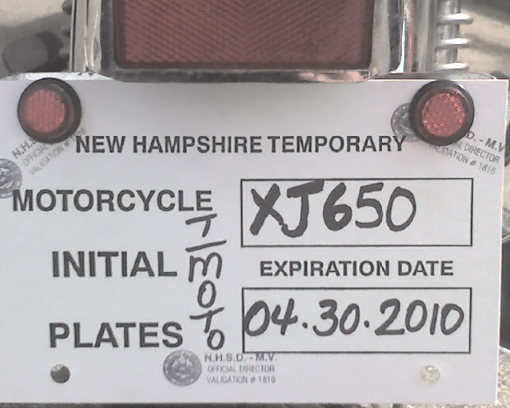

    .25
    HAH!
    OH NO, HERE IT IS!
    Oh you are DAMN RIGHT.
    Can't wait till the real plate comes!!!!! Holy heck yes!
