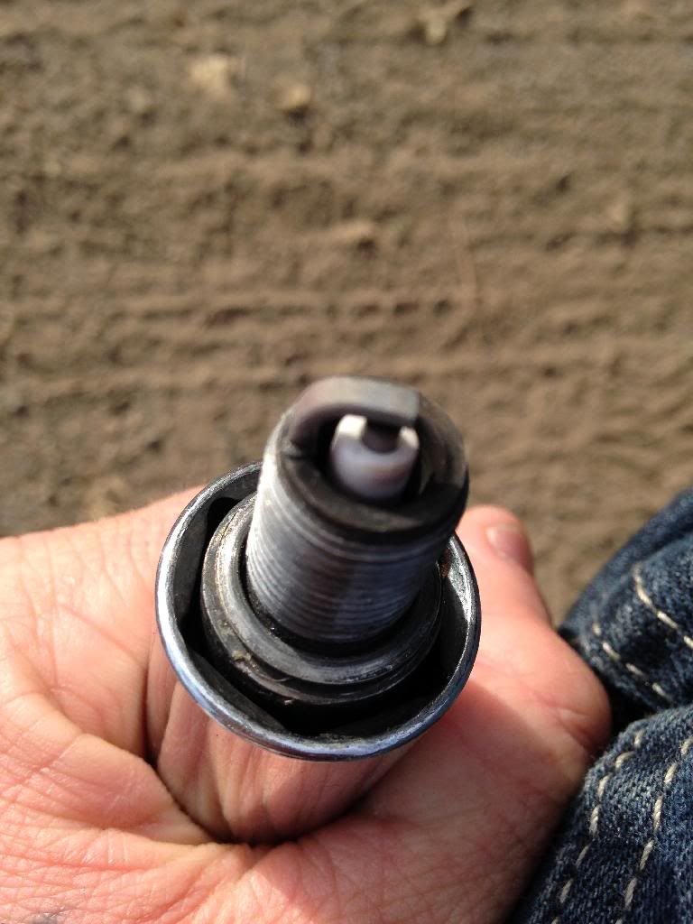

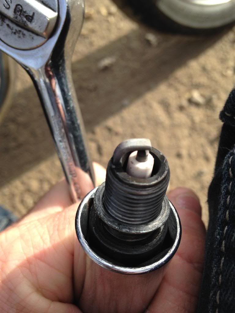

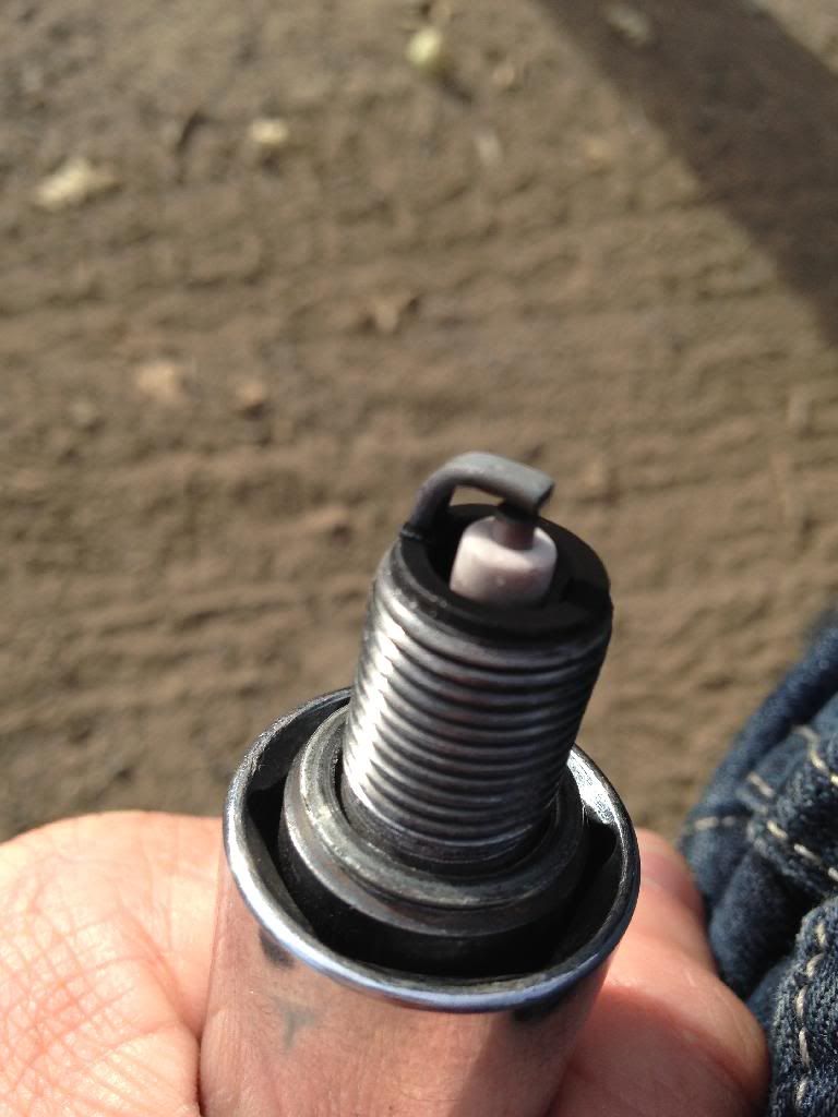

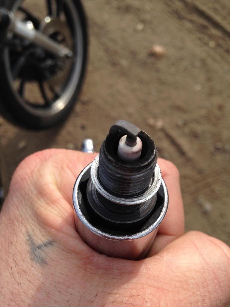

    Okay, so I think I'm pretty close, but wanted to see what you all thought of the plug color.
    #1
    #2
    #3
    #4

  19. wizard
    Still lean & a bit odd, you should be aiming for the brown paper bag look, on the porcelain as well.
