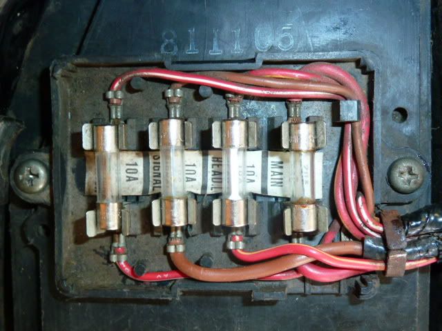

    ***first off my bike is a yamaha maxim xj650 from 1982
    Alright so after my series of problems im starting to get better at trouble shooting. This time though im starting to hit a wall.
    About a week ago on a shitty day my bike wouldnt start, no noise from the engine could even be heard. Maybe once or twice i would begin to hear something but without the choke open it would die out.
    I ended up giving up on that and later on came home and it worked, it worked every time after that for a week.
    The only thing i noticed is the first glass fuse in the set was heating up, all my controls were working, oil light even coming on when i would hit the starter.
    A noise when it wouldnt start was coming from the fuse, almost like a clicking sound.
    Since last week when i got it started i forgot about the problem but now its doing it again, and i have not gotten it to start yet; this time i cant even get it to try to turn over, just the light clicking sound from the fuse box area.
    I have quickly run through the wires and havnt seen any touching metal, everything seems to be connected although i have loose wires that are from old connections since i inherited my bike from a junker that brought it back to life.
    Any guidance will be appreciated and i apologize ahead of time if this is confusing.

    Sounds like a poor connection to a fuse. You can either clean up the contacts or upgrade to a blade style fuse box(recommended).
    Either that or what you're hearing is a solenoid clicking from a lack of juice. Is your battery fully charged and filled?

    The original fuse clips crystallize and break all by themselves, sometimes without being touched. At the very least you'll need to rebuild or replace the fusebox (replacement recommended, rebuild OK if you want to stay with glass fuses.)

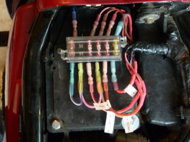

  9. maybe4
    maybe4 Member
    244
    Chicago Area
  10. 3feethighandrising
    3feethighandrising New Member
    25
    damn that looks way cleaner, where did you order a new kit from?
  11. maybe4
    maybe4 Member
    244
    Chicago Area
    pm username "chacal" that's where I bought it from. I got the one with two extra fuses for aux power upgrades and used one of them for a cigarette adapter in the old chain box (you have the same bike as I do). you can search "cigarette upgrade" to see the install pics. I use it to charge my phone while riding.
