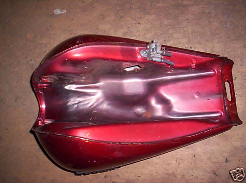

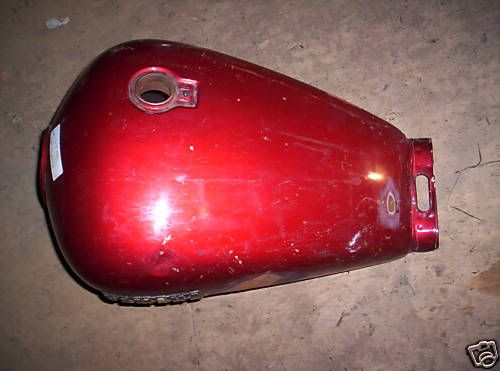

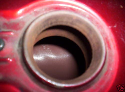

    Well, I have a 750 tank I'm putting on my 650 Maxim. I'm going to be starting on this real soon. I'm going to get all the rust out of the inside and get it all nice a pretty inside. Then I want make nice on the outside. I'm thinking of using body filler for the couple very small dents that are there. Then I want to paint it and the side covers satin black.

    Believe you me Max. I searched high and low for a long time to find this tank and ended up scoring one for $65 shipped. Don't give up hope. A little patience will get you your tank Max.
    Here are some pics of what patience gets you.

    Looks pretty nice to me. Patience done you good.
