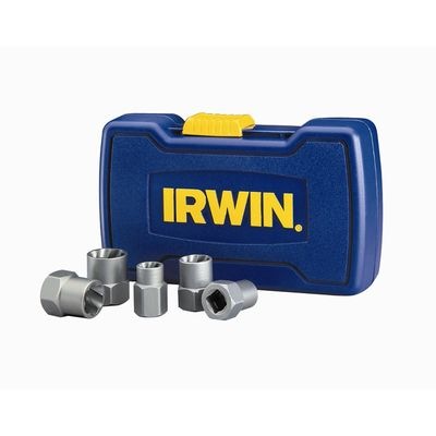

    Rather than pay someone to weld a nut on it go ahead and get a set of bolt extractors. You'll have them to use next time.....
    AutoZone sells this set for $25 in my local store:
    I'm not sure if the link will work without the right cookies (you need to select a store for pricing) but HERE it is.

    My in-laws gave me a similar set for Christmas a few years back. Until I opened them I had no idea there was any such thing.

    even after seeing the pictures i have no idea what they are or how they work. I'm sure they must be handy though

    Yeah, picture isn't very obvious.
    They're like an inside out screw extractor. The opening is cone shaped with aggressive left hand flutes. As you turn it to remove a bolt or stud it just keeps biting harder and harder until the thing breaks free.

    So how's it got it over these, they get tighter the more pressure you use.
