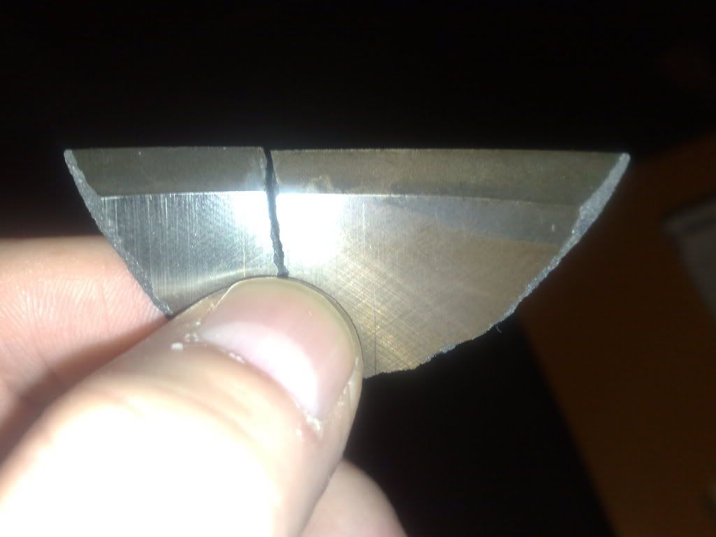

    I've had the 'stuck in first gear' problem. Got out the broken piece of the chain guide.
    I have now removed the engine. Have it on the bench upside down and found These Pieces inside.
    Anyone know what they are and what it means now?

    pic's not super clear... are they metal, and how big? They almost look like they could be pieces of (I don't want to say this) a piston skirt?

    Yes they are metal and they form part of a cylindrical shape and are shamfered on the inside. But i can't see anywhere that the pieces might have come from. As all i can see are cogs, gears and chain in there.

    I reckon it would be about 1.5 to 2" (inches) in diameter (if you had all the pieces and put them together) as the pieces are curved.

    Metric references are easier for me but I'll run with it, you have the remains of a cam bucket skirt sitting there (that is what it looks like to me). You need to open up your valve train and pull buckets.

    Ok, managed to upload another...let me know if this is clearer for you. It's Here

    Broken cylinder sleeve!

    yup looks like the bottom of the sleeve to me too. still has cross hatch on it.

    Oh, man, the pic says it all. Sorry to say they're right. That's the bottom of a cylinder sleeve, the part that fits down into the crankcase. It's chamfered like that to aid in piston installation (you're holding it upside down in your pic.)
    How the heck it got broken like that is anybody's guess but I'll bet the PO knew and didn't share...
    The only time I've personally seen that bit broken was in motor that had suffered a broken rod.
    Could a chunk of chain guide gone for a "ride" on the crank cheek and done that? (Thinking out loud here)
    What's REALLY gonna suck is if you pull the cylinders and the bottoms of all of them are fine, meaning it was debris from a former disaster.
    You're going to HAVE to pull it down and look or risk exploding it if you do have a cracked liner. Sorry.

    I'll confirm the cylinder sleeve. The size (thanks for the thumb) and the cross hatching is a dead give-a-way. Pull the motor, you might have more damage than you think. I'd be pulling the lower end caps to inspect bearings!!!

    Nope, that is the cylinder HEAD, you need the piece that goes below the head, but on top of the crankcase, which are the JUGS..........

    And yes, the broken pieces most probably came from the very lower edge of one of these sleeves, and raises the more imporant issue of why? and what? hit the bottom of the sleeve to cause it to fracture like that. Like Fitz says, you typically see that kind of damage on a sleeve when a rod goes dancing through the guts of the engine before it "exits stage left" through the block.........
