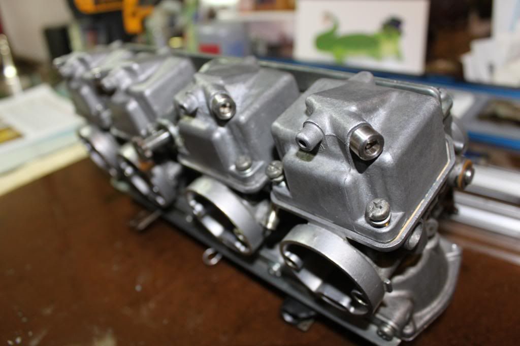

    From a german XJ-rider who´s apparantly good with a lathe:

    I like mine better. I didn't start with an already existing setscrew... I started from scratch :):

    Haha! Of course I'm keeping them! If I were to value my labor as it would be on the open market, I'm into those screws for about as much as my bike is worth. :) The real pain is that blind hex hole. I don't have the equipment to do it right, so I resorted to brute force and ignorance. Those I've got.

    You´re welcome to like whatever you want, bro´; my reason for posting is that I hadn´t seen this (quite elegant, IMO) solution for an allen-headed replacement screw before, and I thought they might inspire to make or get made if needed
    I like these ones because: they are well- and (almost) locally made, extremely fair priced and: Laying here on my desk, ready to be installed :cool:

    Clearly would have been way less labor to buy them, but Chacal doesn't sell what I made. Mine are different.
    Mine incorporate the O-ring feature and they also sit flush with the outside of the bowl once installed. Details that are not currently available elsewhere at this time. You know it's not just about the money, right?

    Polock, A rotary broach is exactly the tool I would add to my arsenal if I were to attempt something like this again. Not currently in my bag of tricks, but it's on the list of future additions. An EDM would be fantastic, but I don't think I'd ever be able to justify having one of them here. I'd have to earn real money and stuff if I did that.
    I mentioned brute force and ignorance above... Machine a hex punch out of O1. Harden and temper it. Drill a pilot hole. A little lube, and then cold form the hex shape in a little fixture on the hydraulic press. OK... So I got the ignorance, but the brute force was hydraulically assisted.

    :) OK then there was a little bit of that medieval stuff... On my first attempt, instead of cold forming the hex hole, I tried to hot form it by heating the pre-drilled slug with the Oxy-Acetylene torch first before driving the punch into the hole. Didn't work. All that resulted was a punch half welded into the hole and once I managed to extract the punch from the hole it was clear that the heat resulted in as much metal moving on the punch as on the workpiece.
    Didn't look quite like the blacksmiths shop, but there were some sparks flying and hammers swinging though!
