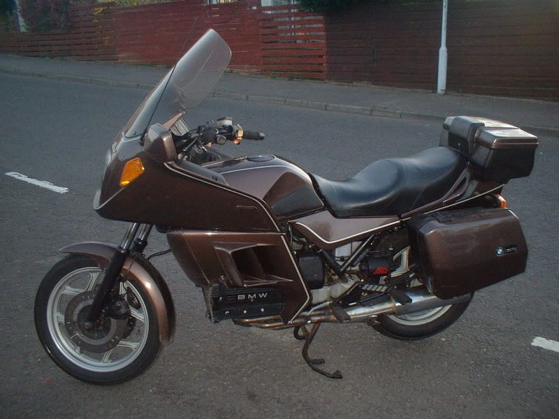

    I've owned 2, a boxer R1100Rs and a "K" K100LT.
    I find maintinence and repairs on them really easy, much like a car. Did 2400 miles last year in 6 days on the RS going to Poland and back. 1 day was 25 hours on the bike. I love 'em!
    I've seen plenty of BMW bikes with 150k + on the odometer, usually clutches last 50-80k, an RS clutch is less than a days work, the frame unbolts and you lift it up out the way to give easy acess to the box and shaft drive,which all comes out in 1 piece...
    Here's me entering Poland for the first time..
    Here's my first BMW.
