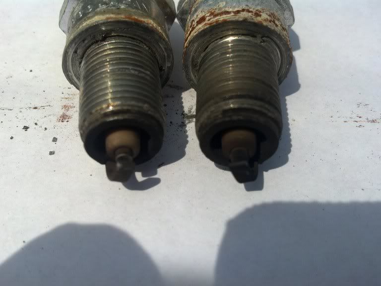

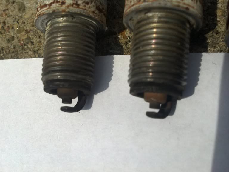

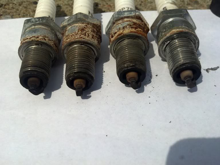

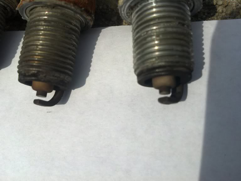

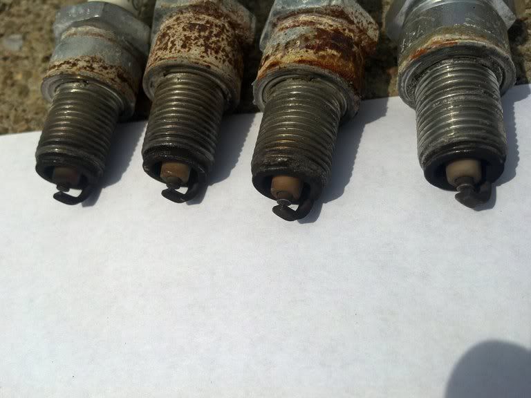

    Anyway, I am happy with it as of now. I'll throw in some plug pics for you enjoyment!
    Cylinders in order from left to right, 1-2-3-4:
    Again, 1-2-3-4:
    1 & 2:
    3 & 4:
    4 & 1 for comparison:
    What are your thought?

    Plugs are purty,,,,,looks good to me

    Well, your results are way varied. Get/borrow another tester or two, at least one of which is verified accurate and retest.
    Plugs...1=too rich 2/3= ok, but slightly rich 4=lean...need to tune carbs.

    The results were slightly erratic. I will certainly redo the test, properly, in the next few days.
    Those were my suspicions with the plugs as well. Like I said, I took it for a little ride, pretest. By the time I had everything for the test and figured out what I was doing, I decided to let her idle for 5-6 minutes to be sure it was good for the test.
    The interesting thing is the muffler mod. I put Harley take-offs on there. I never did get them to make a tight seal where they mount on at the collector. I had to get thrifty with 2 pair of couplers and they let a little escape at the joints. I have always been aware of it and if anything thought it might cause a hair of a lean condition. Although the sound, to me, is better than stock, I have always wanted a little more. Maybe I can get away with a small bore punch for a little more...
