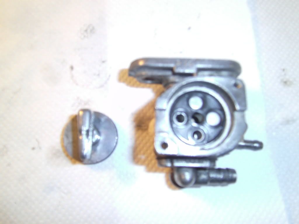

    yaaaay, managed to dissable the auto on feature with your help especially the suggestion by "osprey" to flip the moving part over.
    [​IMG][/img]

    stripped the petcock and filed off the stop tab on the moving part to enable it to spin all the way round

    blocked off the auto on valve with epoxy putty

    made thick rubber gasket and dicarded auto valve plate, and replaced rear cover.sorry for poor pictures
