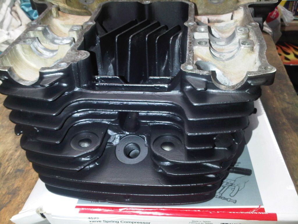

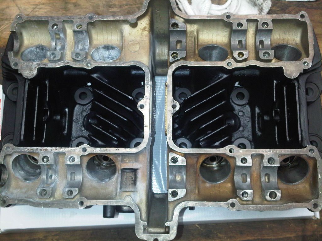

  29. yamaman
    yamaman Member
    822
    Staten Island, NY
    :D :D :D :D MOMENTUM, intake and exhaust are GOOD. Baked the head for 15 mins at 400F, cooled it, it feels Nice and hard, doesn't scratch off. got about 1.5 of cleaning left of random parts and it might be started by dark :D :D :D not going to get to ahead of myself though :wink:
    pretty damn excited
    oh hell here's some pics
    I'll give updates tonight, pretty sure I won't be syncin or colortuning till tomorrow
