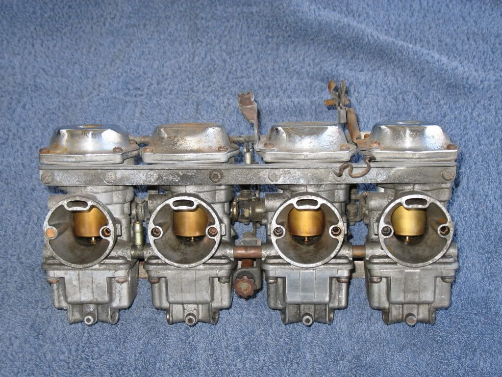

    Well ladies and gentleman I finally decided to start on the Biatch and after removing her RACK of carbies I think she is appropriately named will let the pictures tell her story.
    Have pulled all apart and are now soaking in carb cleaner :roll:
    All comments and helpfull hints greatly accepted

    UGLY! Worth keeping as a sticky to show newcomers to the site how there carbs may look before cleaning?

    yup, they get nasty and PO's always say, well it use to run, but im not sure why it wont start now..

    those are pretty impressive.

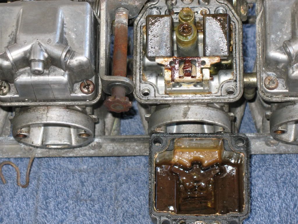

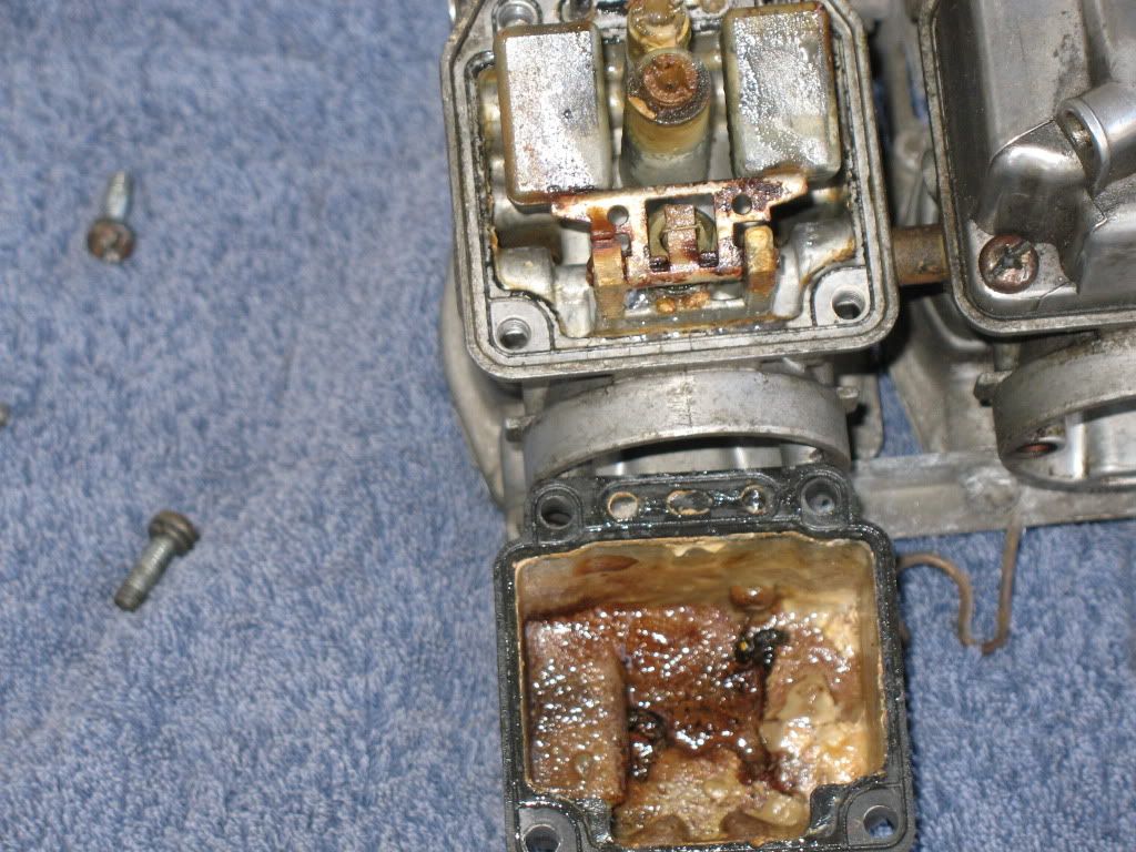

    Looks like ethanol fuel and moisture from sitting around. One reason to drain the carbs and tank when storing these bikes to prevent this from happening.
    Carb soak is going the get a lot of that out but you are going to see some corrosion damage (pitting) in the float bowls. The drain screws are going to be hard to get loose too. Len at xj4ever may have some spares if you need to replace.

    Careful on the carb soak. If you leave them in there too long the aluminum will turn black.

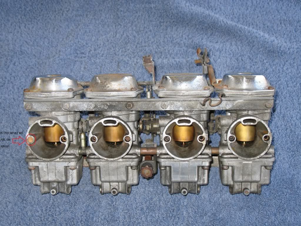

    Whats going on in the second pic..left carb, left air jet ?

    When you order your parts don't forget the throttle shaft v-seals. Your's will need replacing. Also fuel rail and idle mixture screw o-rings. Skip these and you'll just be pulling the rack off again. :(

    :oops: :oops: :oops: beats me never pulled anything like this apart before according to the xj bible the air jets are concealed under the hats :? :? :?

    I agree with Bushy, that looks like a plugged air jet. Different carbs have replaceable and non replaceable air jets in different places, but that one is not like the others... Also, the jets under that hats are the pilot air and main air jets, but I forget exactly what circuits the air jets in the back connect to.

    :oops: :oops: :oops: :oops: in the pic if this is what we are all on about its just been blocked off by a bloody mud wasp lil bastards get into everything :oops: :oops: :oops:

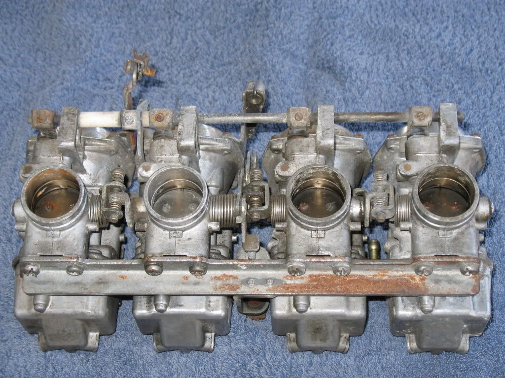

    Ok gurus do I pull this rack totally apart and do these carbies individual. or do I leave them assembled on the rack and pull them apart your input is greatly appreciated cheers

    Take the rack apart. Get new throttle shaft seals and o-rings for the fuel tubes that go between the carbs.
    Looks like you put that whole rack in the carb soak. Are the floats OK? That stuff is alittle hard on composite floats.
    In any case take lots of pictures and just do one carb at a time.
    XJ4ever has kits now that have all the parts and screws you will need, including float bowl drain screws.

    beerhound.. yes, break th rack and put it back together much better than it was b4, they're a very important part of th beast.

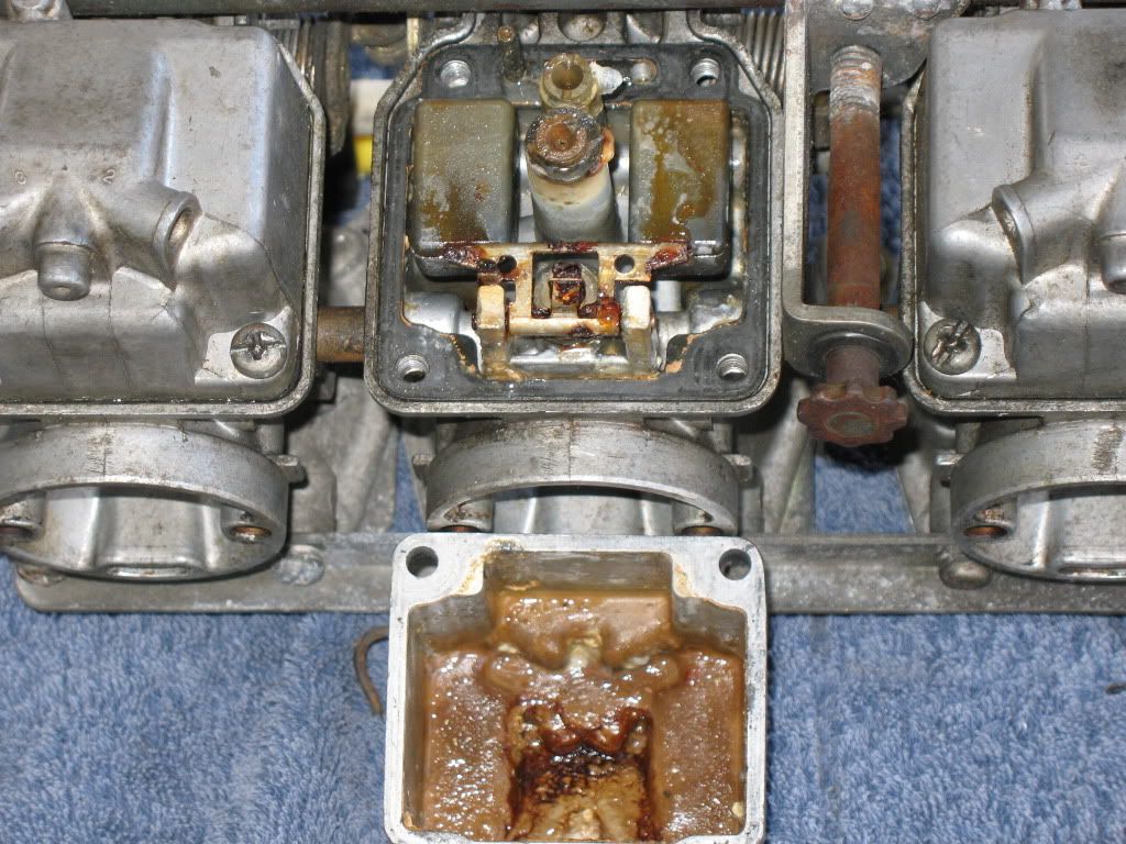

    In the last picture , what up with slots cut into the towers where the pilot screws go?

    :? :? :? :? who's pics mine or RvdH

    RvdH's carbs? Look like the towers are cut?
    Maybe the pilot screws are stuck or something.

    OK 35 minutes just too remove these bloody screws without stripping the heads too pieces
    Well not taking this long so out came a good friend
    The back rail seen what happened too the front hehe
    Diaphram hmm wouldn't want that assisting any part of my body lol
    After all this came too the grand conclusion SCA CARBY SOAK is C R A P

    Yes, it turns out the previous owner (or the one before him) cut into the towers to be able to unscrew the pilot screws. They do seem to be unstuck now.
