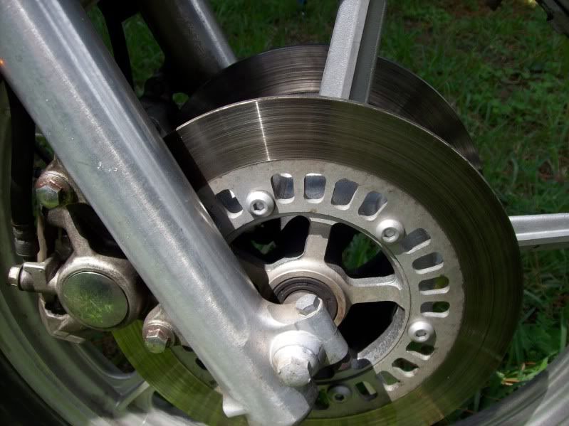

    Second the rotors seem okay to me they are not warped and I put a caliper on them and came up with 1.85 on both is that thick enough.
    Here is the best pick I could get of the rotor

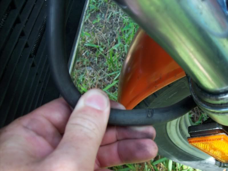

    This is what I found troubling when I was checking the rotors I noticed the brake line was split. So that needs to be replaced. If so am I looking at the right part on bike bandit. Are brake lines really $90 8O If so is there a better place to look, Thanks guys here is a not so great pick of the break line

    Go talk to Chacal. I'm looking at an old list I made up for him, and it shows that line has being about $45 for the rubber. (Add a few bucks for stainless.) Even figuring subsequent price increases, there's no way he'd be charging you anywhere near $90.

    Chuck, we carry both the original style rubber and DOT-approved braided stainless steel brake lines for you bike, drop us an email or send a PM via the website message system for more info......
    1.85 (mm?) is far too thin for the rotors......you may wish to re-measure and confirm!:
    The minimum thickness for original rotors is as follows (these specifications do NOT apply to aftermarket rotors). The maximum allowable "runout" or warpage is 0.15mm high-to-low for all models, all rotors:
    4.5mm for all XJ550 models, all XJ650RJ Seca and XJ650 Turbo models, all XJ700 models, and all XJ750 models.

    Perhaps your units are standard, and not metric? The pics are good I 'd replace the chaffed hose asap.

    Yea I used standard. Opps I converted it and I am good. Thanks alot for the pm chacal. I will be buying all new brake lines and washers. Infortunatly for all those goodies I will have to wait a few paychecks :cry: but I will be using your buisness I am glad to see there are parts still out there.
