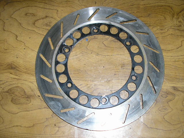

    natedog, I'm pretty sure that the rotors on your bike can be interchanged with rotors from a Radian and they are slotted and are really nice, look:
