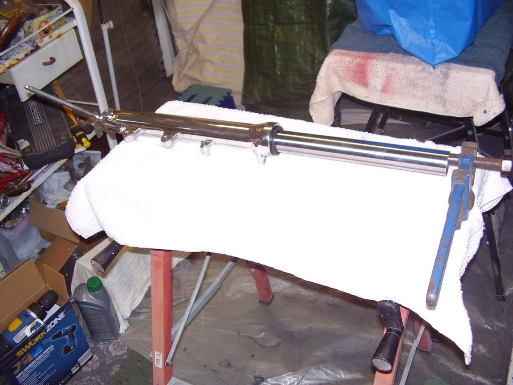

    here is the fork leg stripped down ,you need to get a long socket bar , and a sparkplug socket reversed on the end, to reach down into the fork leg, to hold the damper rod, whilst slackening the bottom alen bolt.

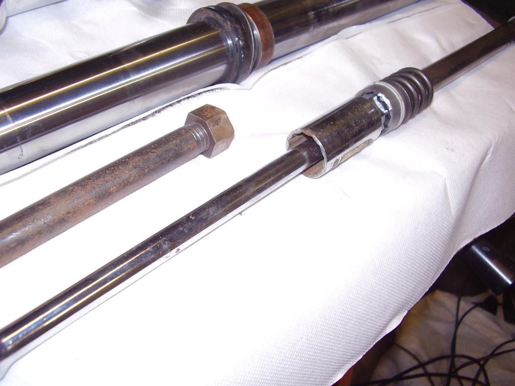

    heres the top of the damper rod , it has a 19mm inverted socket.
    you could also use a long 19mm bolt , heres one with a nut welded on the end
    heres the bolt inserted in the leg

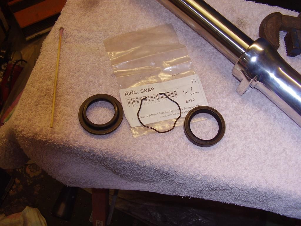

    the only "ring" that is part of the dust seal ,would be a spring ring which pinches on the rubber
    heres a new set of seals and snap ring, the coil spring is on the dust seal on the left,
    unfortunately its on the underside,
    these are the only rings ,apart from the flat washer that goes under the oil seal.you can see that here between the oil seal on the leg ,and the copper bush

    no ,there should be 2 bushings on each fork tube,
    one just below the oil seal ,the other ,shown here , on the bottom of the tube. the bottom one has a split in it ,so you can spring it apart and slip it off the bottom of the tube.

    im not sure i have one of those. hmmm can i get a closer pic?
  25. bensalf
    bensalf Well-Known Member
    1,370
    286
    yorkshire ,england
    i'm not sure i have one of those. hmmm can i get a closer pic?
    its the same pic as on page one, 3rd one down, it's a little clearer on that one
