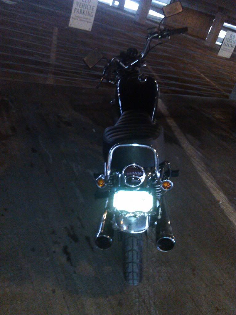

    Ah, but I have a secret weapon.
    My other bike:

    Does the XS400 has those special bolts you can adjust at the end of the rocker arms to have the right clearance?

    Yep. There are four plugs at the top of the engine, pull them off and you get to the tops of rocker arms. 10mm wrench and a Philips screwdriver, and you're set to adjust. Takes about 15 minutes to do.

    No, the rocker arm has a screw through the top of it and it has a jam nut. Dirt simple.
