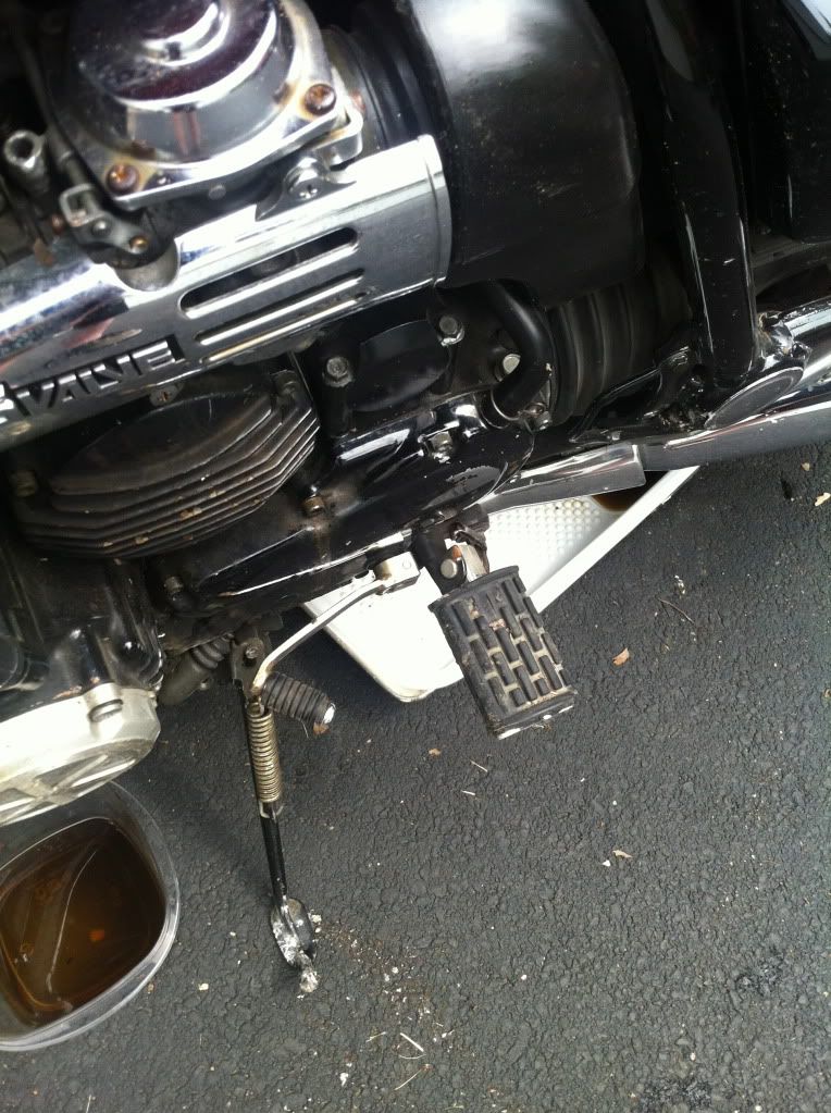

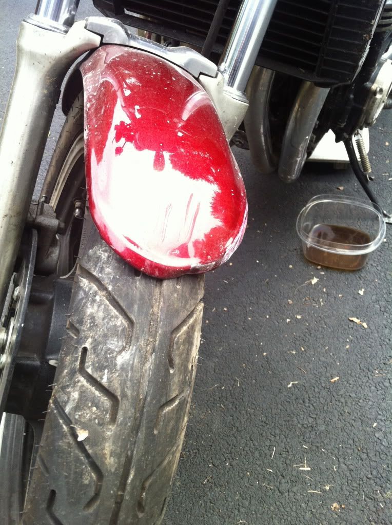

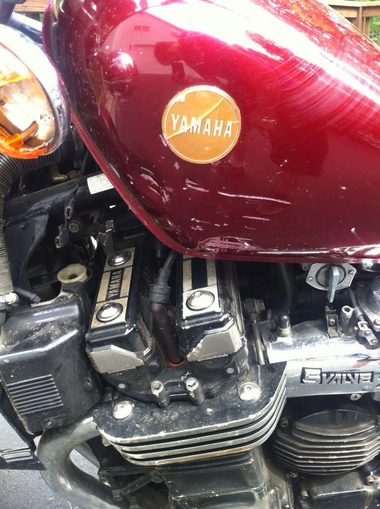

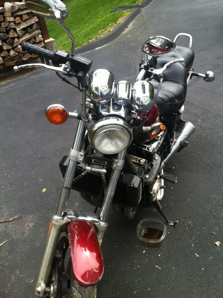

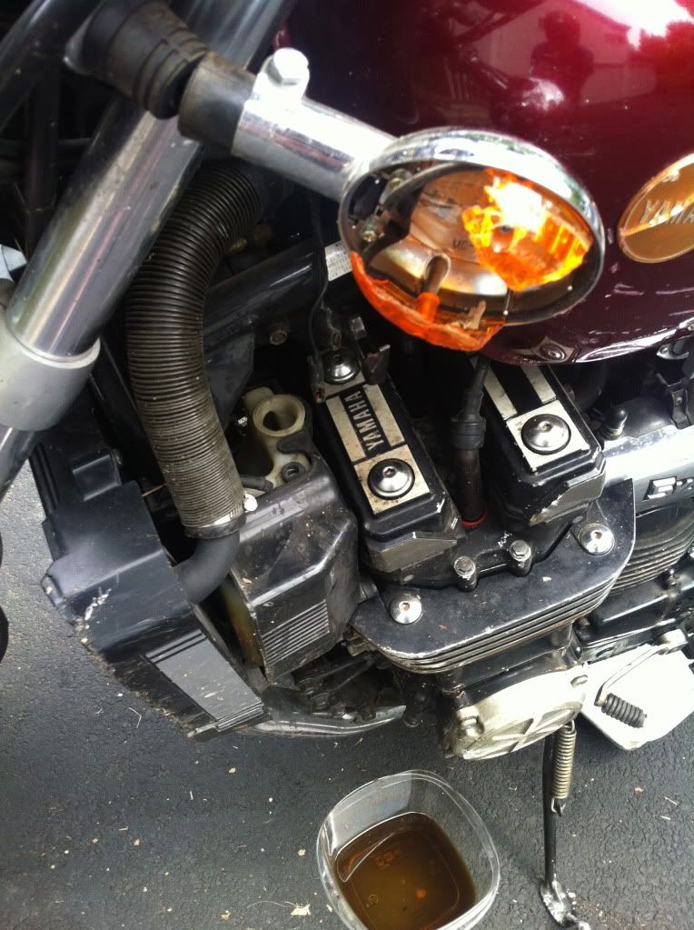

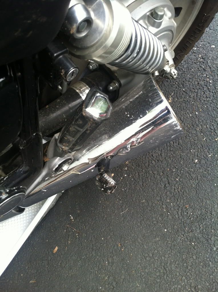

    Maybe I can throw up some pictures and you guys can tell me what you think?
    Frame looks straight as far as i can tell as do the front forks...
    It leaked oil so I haven't tried starting it... Yet all the electronics work.
    it looks fixable to me... I'll throw up some pictures you guys can tell me what you think. I Found out my room mates dad used to be a mechanic and owned a bike shop back in the day and knows these bikes very well actually so he maybe able to help with any repairs I need.
    Or is it best to just move on and look for another bike ( :cry: )
    It doesnt look awful but maybe I am wrong?

    I'd say it can be fixed, just start with the things you NEED to get it road worthy, and fix the cosmetics later on down the road. Check the forks with a level or plate glass, mine got twisted up in the triple-tree and looked bent.

    well your sort of ok, that's the good part, the bad part is that oil. that's going to be the big one. start looking for another bike........then you'll have two

    In all honesty I think the stock blinkers (turn signals) are rather large and don't fit with the go fast look of XJ's. The chrome is their only redeeming feature. I have some slim-lines on the 550 that look much better in person. You can't really see them too well in my gallery pic so I will get a close up so you can check them out.
    Bars come in a multitude of styles and sizes. You'll want to measure the good side to the center of your current bars for reference, and then just get some that change how you would like them to. You need to measure width (1/2 your current and double it), rise, pullback, and sometimes center (how wide before the bend begins).
    When it comes to paint you can go one of two directions. Either inexpensive or professional. Inexpensive can look 'ok' but it isn't durable and won't look as good as 'pro' or as right. It's all about the primer and the paint. Rattle can is def. cheap way to go. If you go back to bare you will need a self-etching primer and you will either need a big compressor and nice gun, or pay someone to do it for you, and some quality paint.
    Based on your pics I would think it is salvageable. I would try and get the max from your insurance w/o letting them total it and haul it off for salvage.

    I have been wanting to do a integrated led tail light/turn signal like a moder super sport... But am worried about electrical gremlins that I have seen posted on here. Same thing with wanting to do a brighter (led or halogen) head light and better turn signals?? Any way to do it sure fire without worrying?

    Also while we are on the subject... My left exhaust got smashed as did the bracket... So it got me to thinking with my white and black look...
    How difficult would this be?

    And one more thing.. How do I take the yamaha badges off my gas tank? One of them is smashed so I figure why not just remove both when I repaint/putty.

    before you get started, hobble your scuffed up butt out there and see where that oil came from! you might have a hole in the cases, that's a game changer.

    If you find out you have a hole in the case, DON'T give up just cuz of that. Case parts are still available, too.......and they're not unobtanium, either.

    I am planning on doing just that tonight...Just put a little oil in the crankcase and see where it comes out is the plan..
    I know that there is a hose of some kind that is disconnected in the center of the bike underneath. I'm assuming it is associated with the drive shaft.
    I got the bent bars off, fairings, and the tank last night.
    It looks to really not be in that bad of shape. The exhaust has a couple dents but no holes which would have been the first thing to get smashed...

    Is my thought of just putting oil in the case and seeing where it comes out going to work?

    Worst case for the oil leak is a crack in the engine block and you can get a replacement via eBay for about $300. I have no idea on the mufflers. Did the fairing get damaged?

    Is the front fairing what you were referring to? there is some minor scratches on like the valve cover. I'm going to pour in some oil and see where it comes out of tonight..
