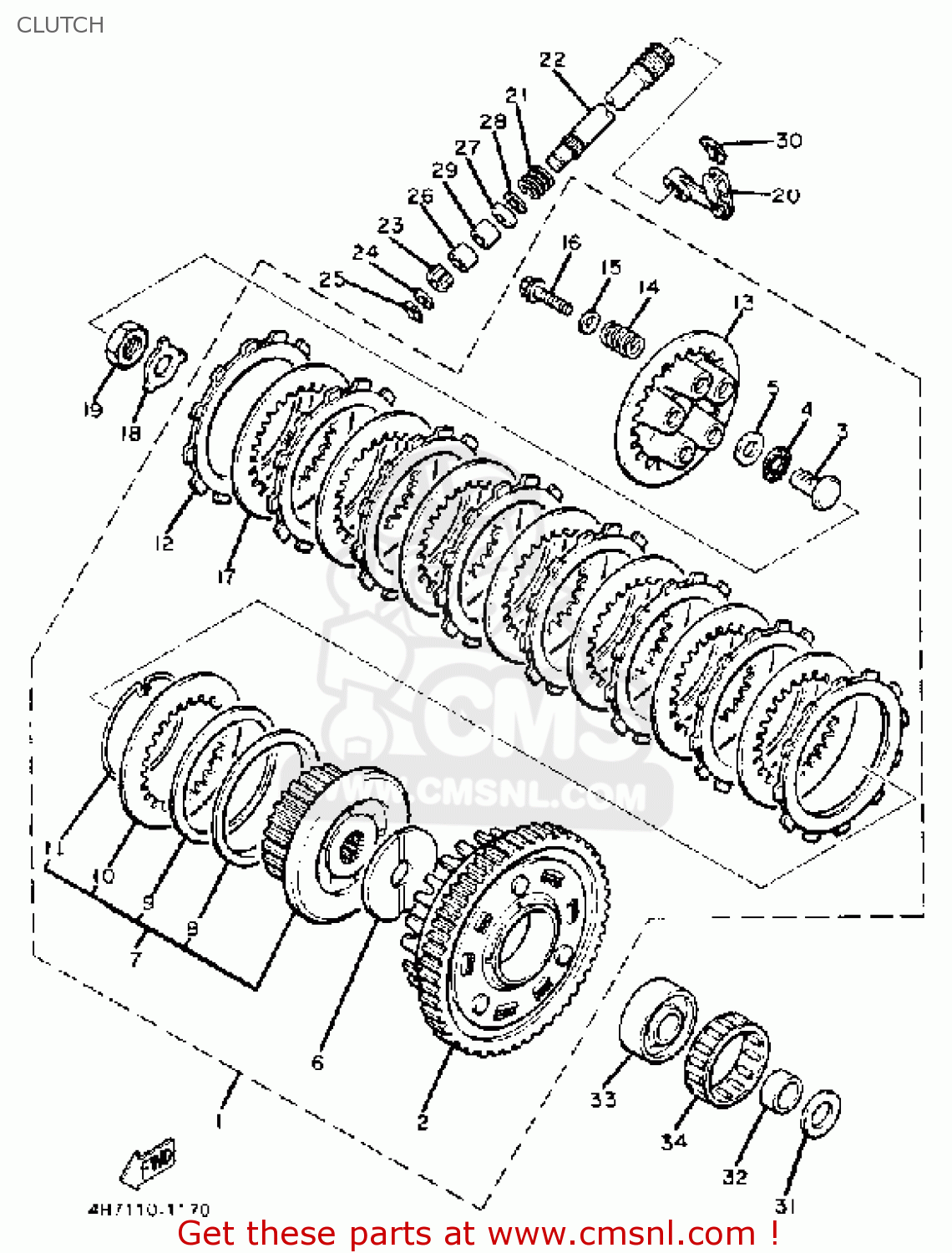

    Ok here goes,,, it turns out that the Previous owner had incorrectly installed the clutch in the first place (and i was a dummy in not checking it) but hey, that's how we learn right!
    Anyway, as i said before i completely removed the clutch and re-installed as per the manual.
    However, what i failed to do was make sure the the lugs on the back of the clutch boss assembly no.7 on this page was engaged with no.6 and it wasn't seated properly.
    This had the result in the clutch boss assembly not spinning!
    (Which i failed to notice) so each time i put it back together i tightened the boss nut and didn't realize that the whole assembly in the middle should rotate freely.
    Now i feel a bit of a dummy, but i've never done the clutch before.
