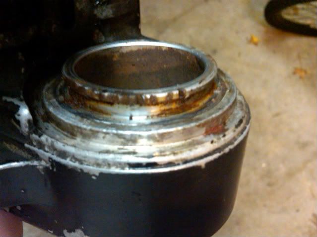

    So I get the brake caliper off. The piston will NOT budge. Looks like the PO tried to use vise grips or monkey wrench or something to twist and pull the old piston out. So I'm guessing I will have to get the new piston. My immediate need is help on getting the stuck one out. Any good suggestions??

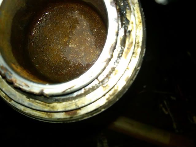

    Personally, I've never had much luck with compressed air; and I've never tried the "steam cannon." I've used the grease gun trick many times with great success, but it is rather un-spectacular.
    Back to the original question: Clean the piston up and carefully inspect it. As long as any pitting or "teeth marks" are not in the area swept by the seals, then you can re-use it.
    This piston, for instance, was perfectly serviceable; the pitting you can see is above where the seals ride:
  14. wizard
    You can get away with pitting pretty much anywhere on the piston, as long as the 'pit' is less than 3mm wide.
  15. bigfitz52
    What, is it "pee in Fitz's cornflakes" day?
    The pitting on the piston in my pic, if in the main seal area, would be severe enough to leak.
    Granted some pitting, just luckily placed in non-strategic places, won't leak because the piston moves such a very small distance; whereas if it had a 3/8" stroke it would be all over.
    But the "judgement call" between what will work and what won't takes an experienced* eye like yours or mine; 'tis better in my way of thinking to recommend on the safe side rather than tell somebody it's OK to use a ratty piston with disastrous results.
    The piston in the pic is currently in my '81 and has a bunch of miles on it (would have to look at log) with no issues; but had those pits been in the seal-swept area I would not have used it myself.
    You are correct; I just prefer safe over chance.
