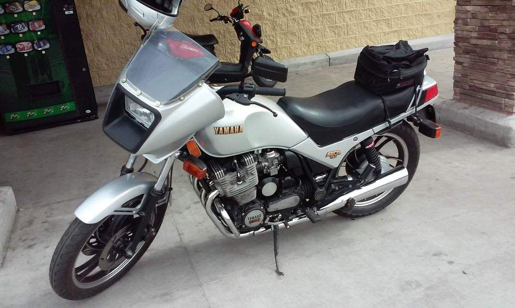

  8. Steve R
    Steve R Member
    110
    Kansas
    [​IMG] Here is a pic of mine. I made the windscreen.
    k-moe likes this.

  10. Steve R
    Steve R Member
    110
    Kansas
    [​IMG] I reposted my 1983 XJ750, i did not see the pic here with the sport fairing!

  12. Steve R
    Steve R Member
    110
    Kansas
    Thanks, a lot of work. Well worth it!
