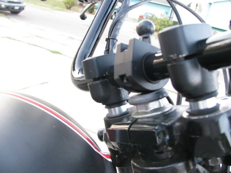

    I spent a lot of time searching through the forum to figure this one out so I thought this might be helpful to others. Most of what I found suggested that you need to swap out the whole top of the tree with a Seca or something but I think this was just soooo much easier. Not to mention cheaper.
    All you need is a couple bar clamps from an '82 Virago (or something similar). I got these off ebay for $15.

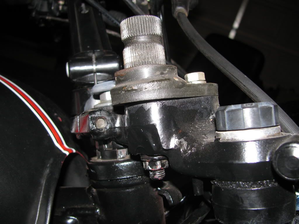

    You'll need a 5 & 6 mm allen wrench to remove those ugly 2-piece bars. When you have them off it's time to remove that splined bar mount. There should be a small kotter (sp?) pin that you need to remove from below the nut, the simply remove the nut from the bottom and the bolt from the top in front of the splined shaft and slide the bar mount assembly up and out.
    The studs from Virago bar clamps are a little long so you'll need a spacer. I picked up these 1/2" bushings and rubber washers from the local hardware store and they worked perfectly.
    That's really all there is to it... I finger tightened everything until I had the bars in place, then went back and snugged everything up (The little clamp in the center of the bars is for my Garmin GPS/speedo).
    I hope this helps some others out.. feel free to hit me up with any questions or comments.
    Just for the record.. those are TC Bros. Lane Splitter bars & I'm not completely sold on them but they kinda' grew on me overnight. The only mounting issue for these bars was the brake line is too short so they're leaned forward until I can get a longer one.
    Cheers! 8)

    Hows that tilted master cylinder workin out? Mine was situated similalry and leaks pretty badly...

    The master cylinder is holding up fine, no leaks. It's actually not far off from the angle it was already at with the factory bars on there. I'm pretty sure I ready somewhere that this model has the master cyinder mounted at a 40 degree angle (Why? I have no idea).
    Edit: quoted from Chacal in a different thread:
    "The XJ750 Maxim master cylinders are designed to fit the stock handlebars and use a "tilted reservoir" orientation when mounting to the bars.....the tilted reservoir thus compensates for the tilt in the handlebar angle and allows the reservoir (and the fluid in it) to remain more-or-less level. Most other master cylinders (including the Turbo) are designed for much flatter handlebars, and thus have the reservoir parallel to the mounting angle of the master cylinder bore.
    The use of "flat bar" mater cylinder/reservoir units on bikes designed for the "tilted reservoir" master cylinders can, under certain situations, cause brake fluid starvation, as well as having your right mirror (which screws into the m/c housing) sit at a very odd angle."
    So, with that in mind, I think my original bars were adjusted to a pretty flat position that put the MC at an angle to begin with. I haven't experienced any issues with leakage or brake fluid starvation but it's certainly something to consider.

    ...angle not much off from what it was...........
    Then something is wrong, or the picture is screwy, cuz the maxim reservoir was never even close to THAT angled that I know of, based on the pic we're looking at.
    Keep an eye on it anyway....................
