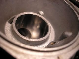

  17. RickCoMatic
    13,842
    67
    If they never have been done, the Diaphragm Piston Bores should be refinished.
    The Bores get a coating of Oxidation that causes the Piston to slow-down, chatter or just not move.
    The easiest way to clean them is with ScotchBrite Medium Gray Pad.
    Scrub them all out.
    If you have a Dremel and Polish 'em up nice, ... that's even better!
    SCOTCHBRITE SCRUB:
    POLISHED BORE:
