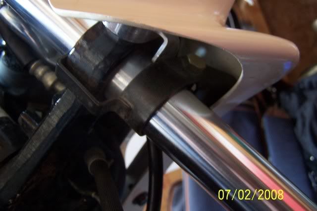

    Couple photos of how it attaches.
    The fairing attaches to the fork tubes and the bar that hooks on to the bottom triple tree and spans the fork gap.
