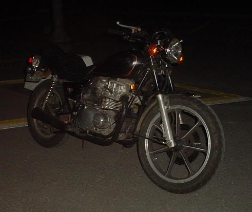

    thanks guys.... i would just like to get this thing to the point that my old bike was.... just get it started and take off
    pic
  27. chacal
    9,164
    1,973
    Ummmmm....something looks funny........that's not the 1100, is it ????
  28. Deathmetaldan
    Deathmetaldan Member
    226
    Sunbury PA 17801
    no, thats my old bike... kz440
    way way way way way to small to be an 1100, i guess i should try and get pics of the xj so you guys can see what im working with huh?
  29. chacal
    9,164
    1,973
    Okay, whew! Had me going there for a moment........!
