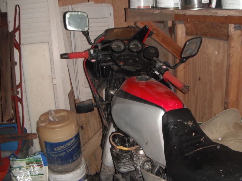

    First....yes, I'm guilty of negligence. She's been in this shed since May 2000.
    Umbrella removed:

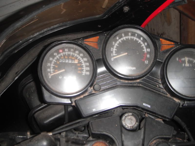

    And only 30,992 miles!

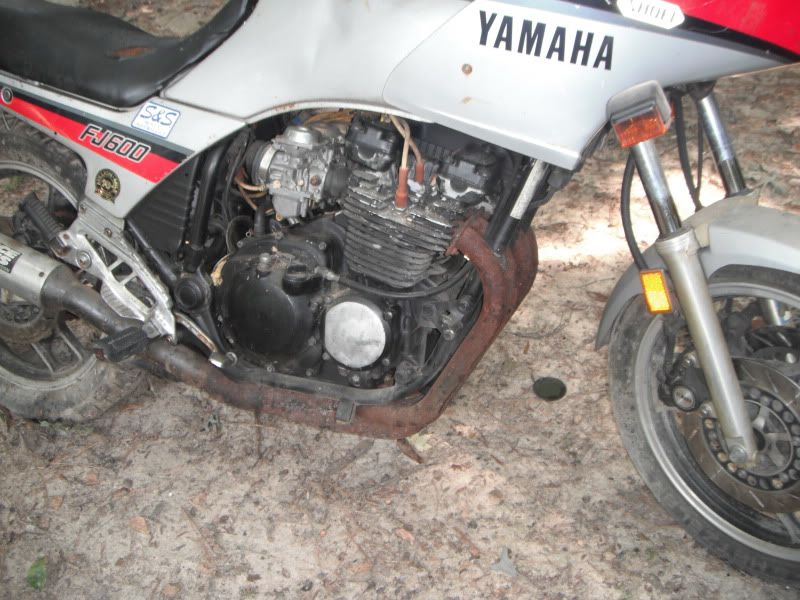

    It really only gets worse from here:

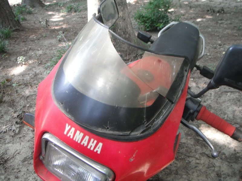

    Windsheild is a goner...knew that

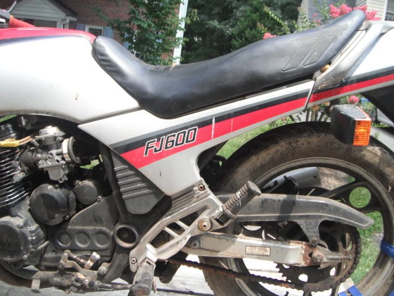

    Sidecovers are pretty ratted out
    New flo-thru vision!
    fork seals are.....good??? really?

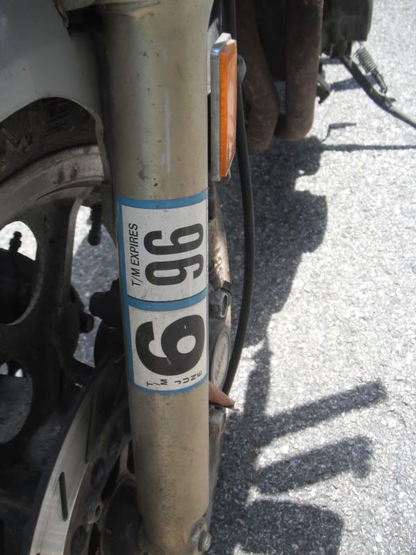

    Last shot in the old 'hood
    Parked in 96..
    It was June....i was broke

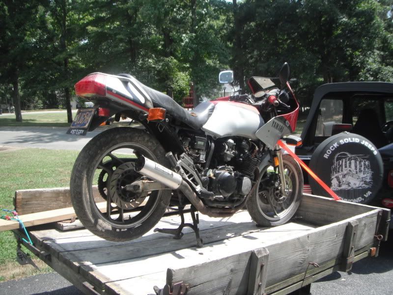

    All tied down on the trailer that brought it here 11 years ago

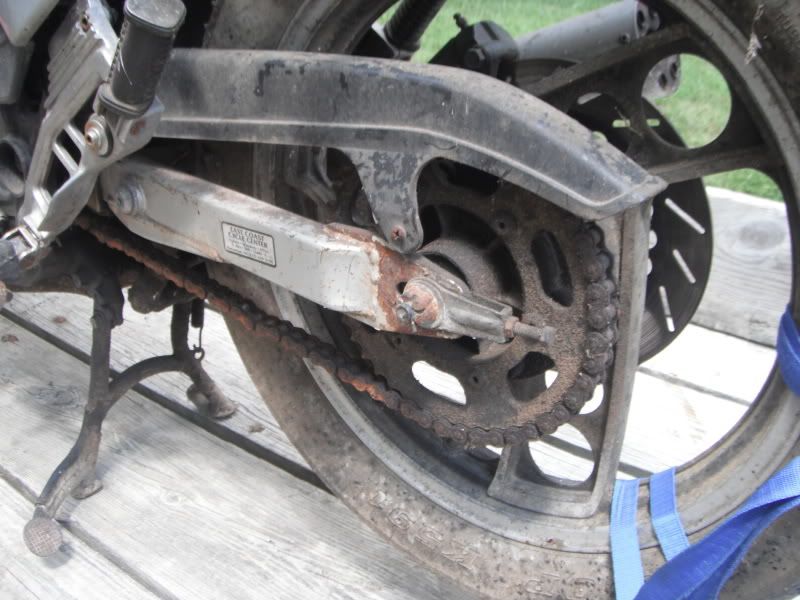

    I know for a fact that chain is kinked

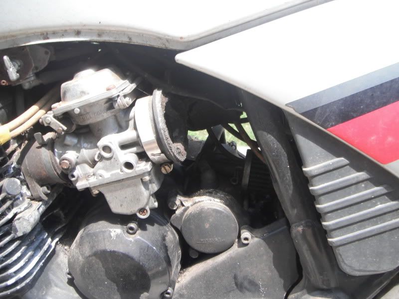

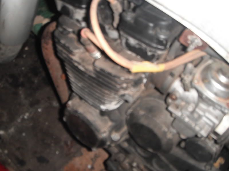

    Look closely, and you can see where mice were living in the tail section
    Pod filters gave up the ghost a while ago

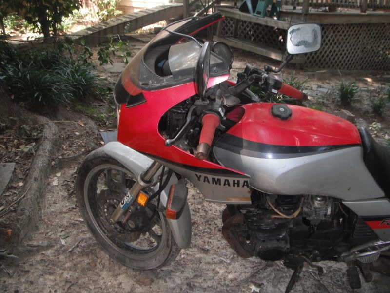

    Chipping away at the stuff that will make it a solid runner, and stopper. the rest is just decoration, although I am looking forward to putting the new-to-me fairing on and side-covers. She'll always look a little rough around the edges, but I don't think I'd have it any other way.

    That being said, I'm glad to see another chain-driven XJ back on the road. Speaking of which, replace the chain (and sprockets) before that internally-rusted chain breaks, wraps back around and rips the starter out of the engine cases, breaking the castings. It's happened, don't let it happen to you. Once a chain has rusted inside, and compromised the bearing surfaces of the pins (which you cannot see) it's a recipe for disaster and can/will fail unexpectedly. REPLACE (with sprockets.)
