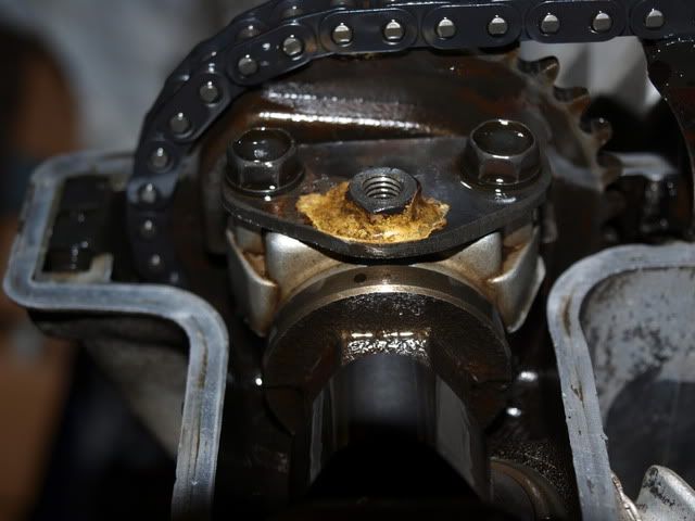

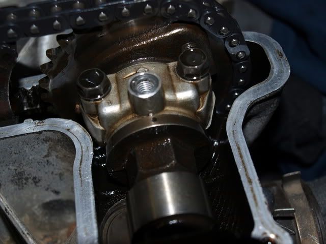

    i was wondering if the marks are on identical positions on the intake and exhaust camshaft caps?
    the t mark on the timing plate is aligned with the index mark
  2. maverickbr77
    maverickbr77 Member
    859
    Lowville, New York
    yes they are in the same position. your repaired one is about a tooth off

  4. wizard
    They don't line up dead on, I think one tooth would put it way off.
  5. maverickbr77
    maverickbr77 Member
    859
    Lowville, New York
    mine were pretty well dead on on my 750rh
