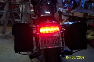

    The LED truck lights work very well for the tail light on a bike. I have the oblong LED tail light on my Seca now. It's very bright!! I mounted it under the bobtail fender:
    With the brakes applied:

    Painter...where did you get those and how did you mount them? I can't quite see them in the pic, won't get big enough!

    I believe I got that light at Walmart for about $16 or so. There are alot of places that have them (truck stops or Fleet Farm stores) but they want a bit more for them ($24- $26 each) Also, there are plenty of them on Ebay for even cheaper.
    The way it's mounted is I made L-brackets mounted to the inside of the fender (where the signal lights mount) and made a flat aluminum plate and just used screws to attach it to the L-brackets. The light itself is just glued on with GOOP. Being the LED lights rarely, if ever burn out, I figured gluing it on would be the best. I could've installed it in the rubber grommet that came with it, but I would need to cut the opening out to install the rubber. That took up too much room and looked tacky.
    You can also use one of the 4" round LED lights that would work or mount it on the side of the bike if you like that idea.
    They take less juice to operate, are much brighter than any stock tail light, water proof, vibration proof and last forever. You won't have to be concerned about your tailight burning out either. Can't beat that!!

    And you use the trailer adapter to wire it up to switch from dual filament to whatever it uses? I could prolly figure that out on my own, but I won't see my bike for about a month longer!
