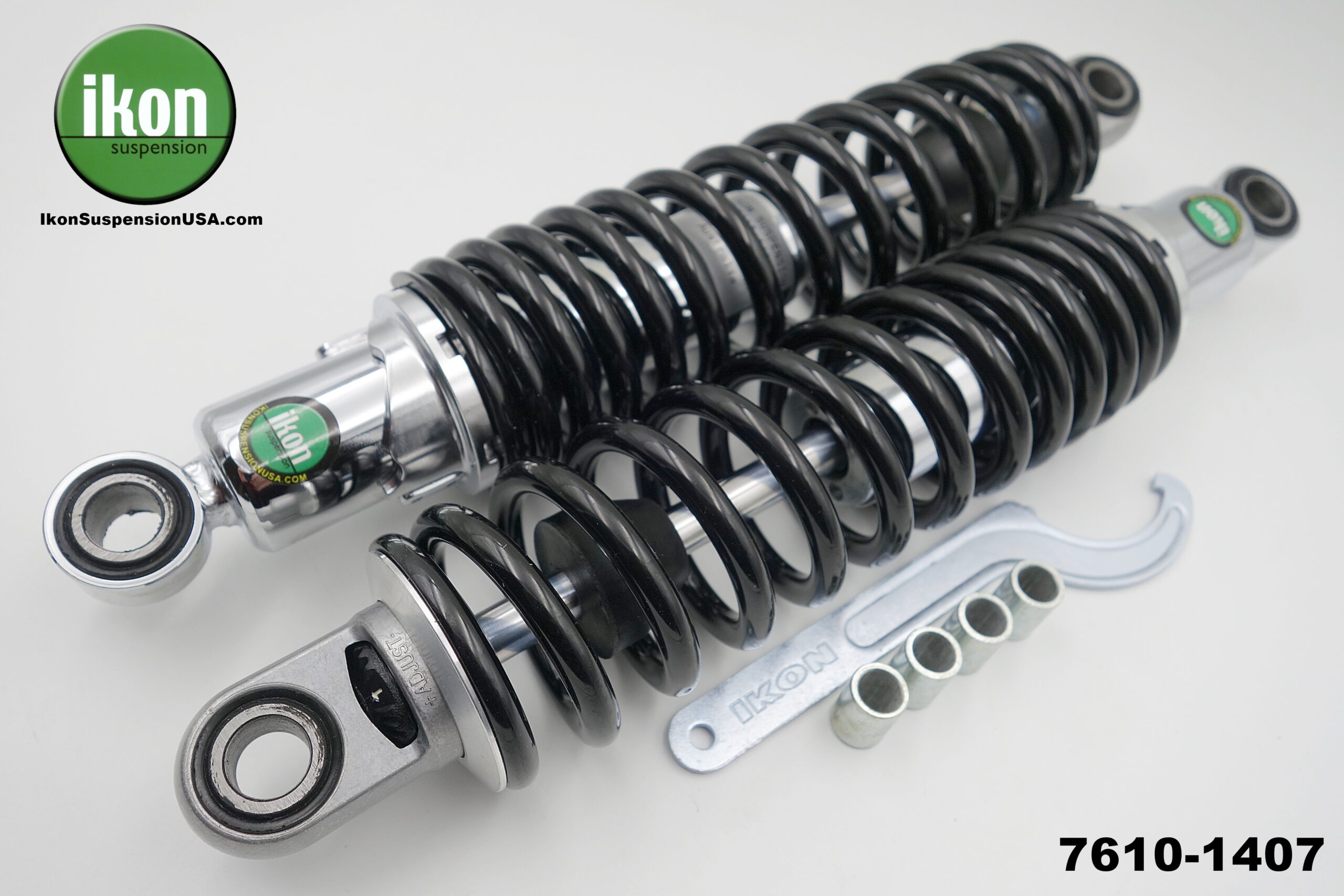

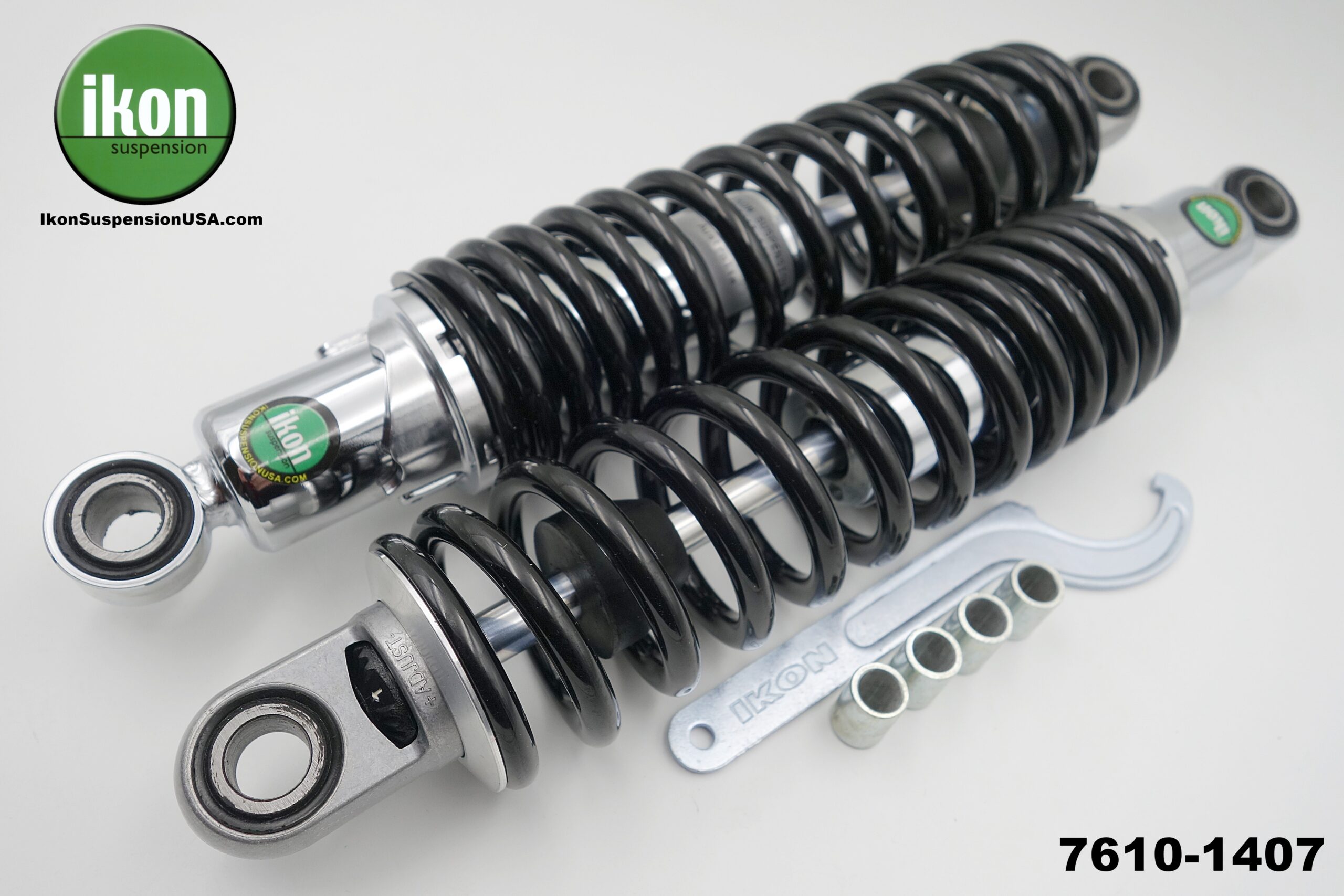

    Well i beg to differ, I did what you suggested Polock .. no bubbles noises, no leaks, adjusters changed but i wasn't happy with the ride feel so i got the Ikons (made in Aus' ) as well as new progressive fork springs. They were the biggest expense in my rebuild and will last a long time. The ride is much smoother and it handles better.
    But yes if what you've already got works as it should and you're happy with it then don't bother spending the money.
