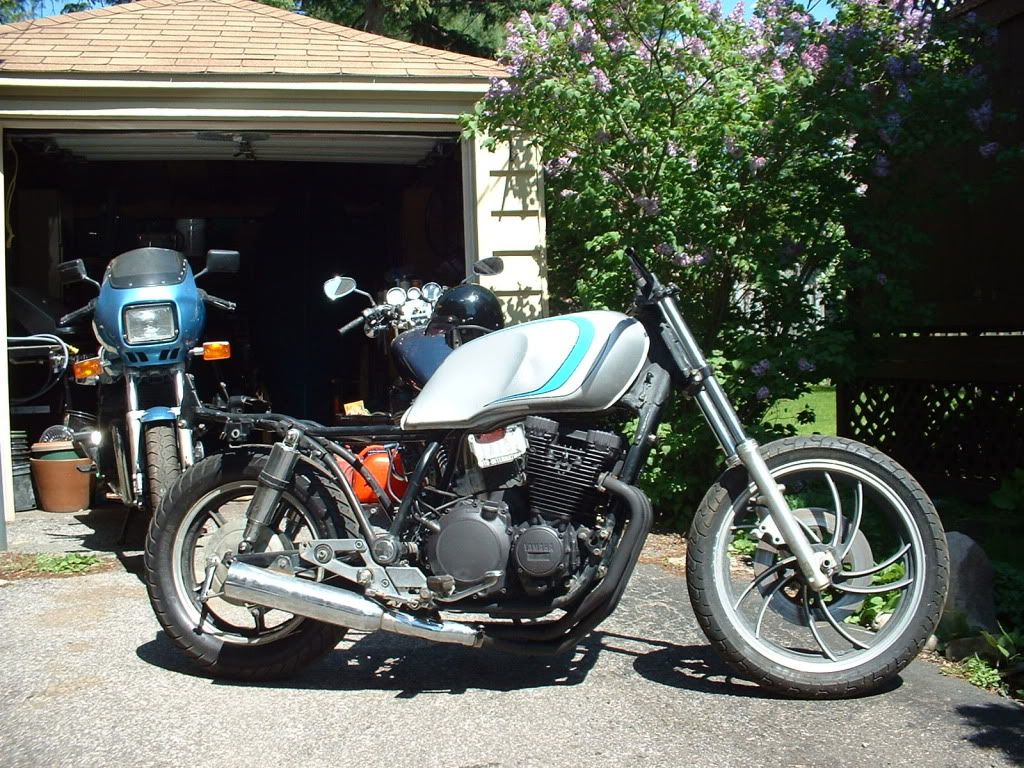

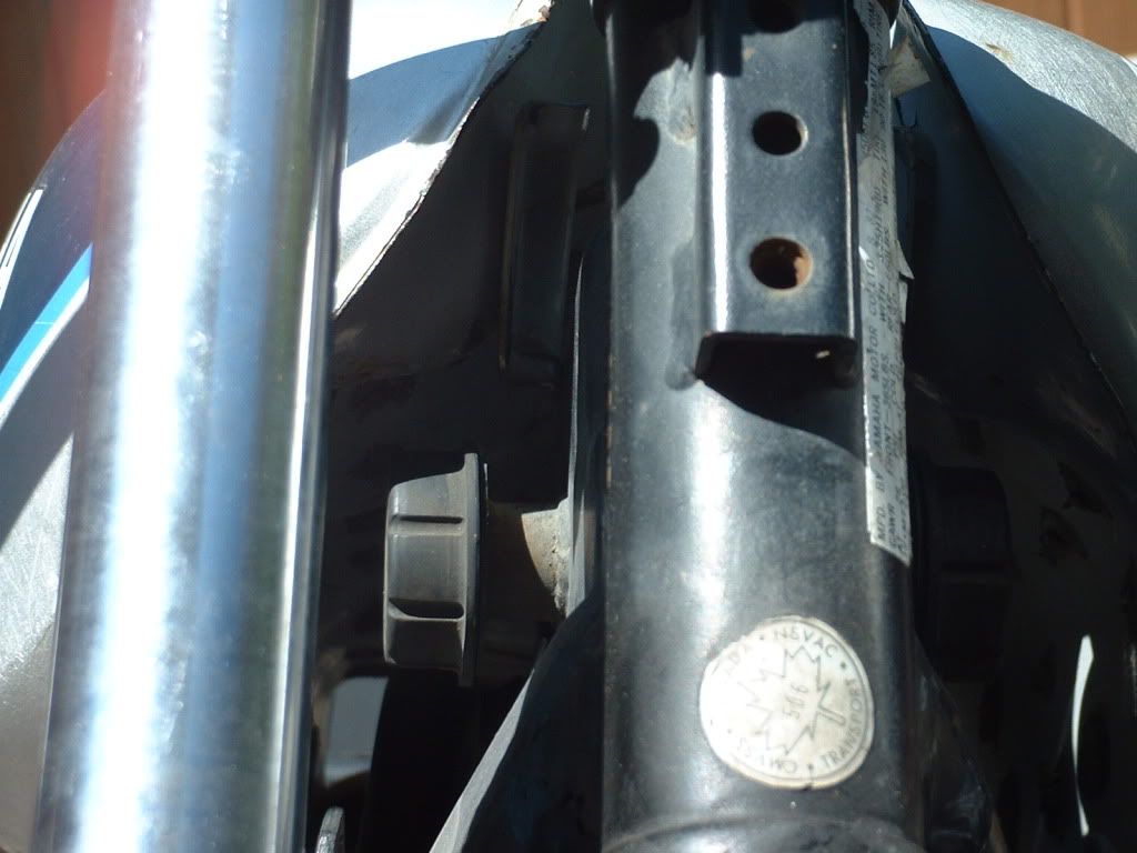

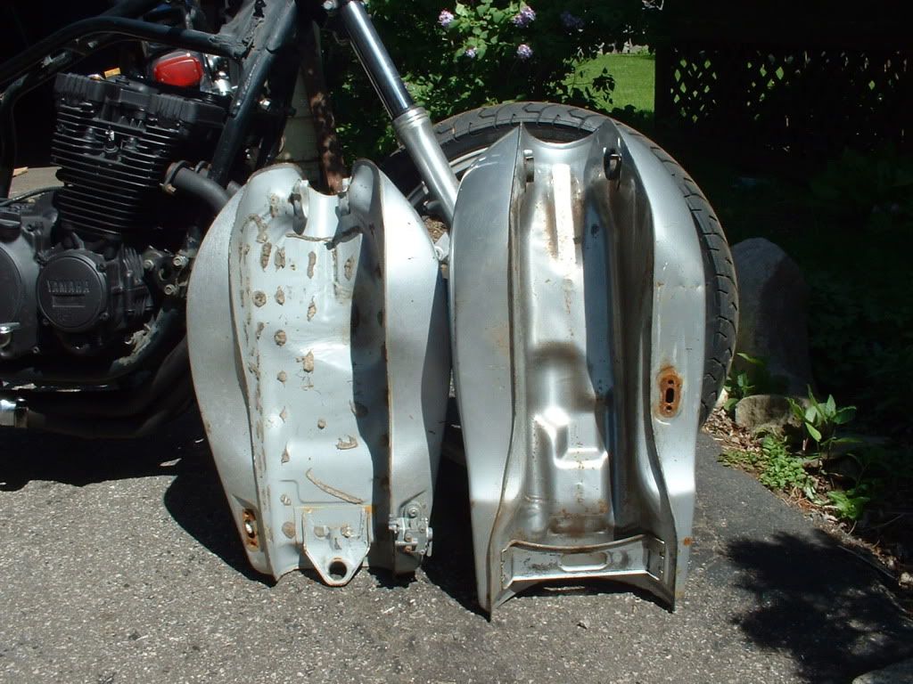

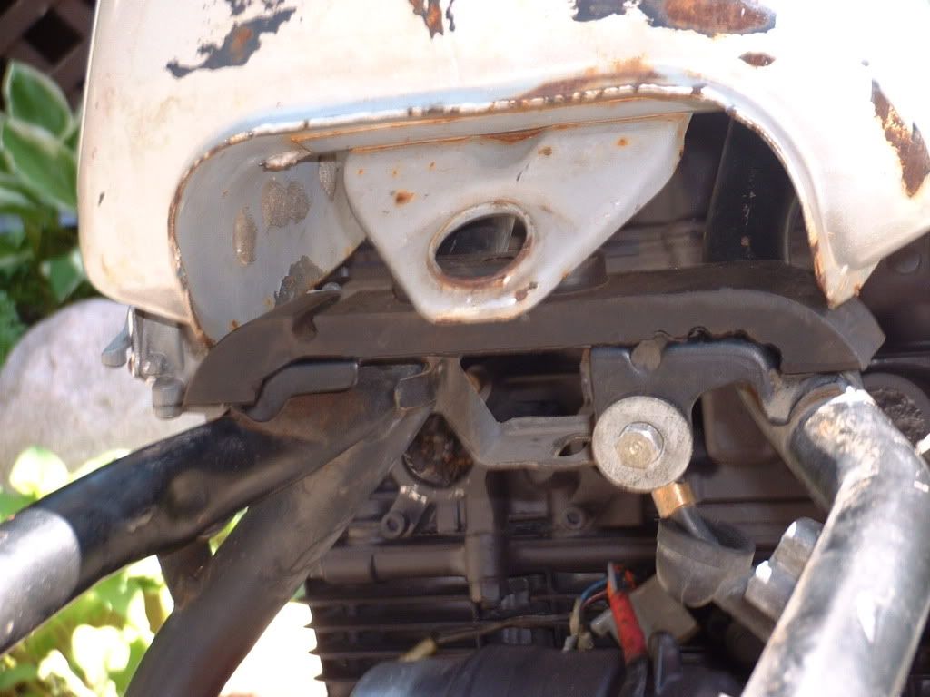

    Well, if you're serious about, you've got some work ahead of you. It's not going to be a simple swap. The front mounts on the XS tank are about two inches closer together and quite a bit higher too. And the rear mount is round, but that's not a big deal...
    It's a nice looking tank and looks not bad on my Maxim frame, even if it sits maybe just a little bit too high. For the work involved in fitting it, you might want to think about just going with a Seca 650 tank. Not all that much different from the XS tank and pretty much a straight swap.
    I took some pictures but I have to apologize for the quality. The GF took the good camera to the Grand Canyon this week so I had to use the crappy old one. The good thing about her being gone this week is that I was able to bring home the little sweetie in the last picture. I haven't been able to take my hands off her all week! :wink:

    I was hoping to some tuning and tweaking on it today but I just cleaned the air filter and it's not dry yet. Should be fine tomorrow. Btw, I lowered mine a touch. Slapped my Savage shocks on it to bring it down closer to what 30" inseam can handle.
