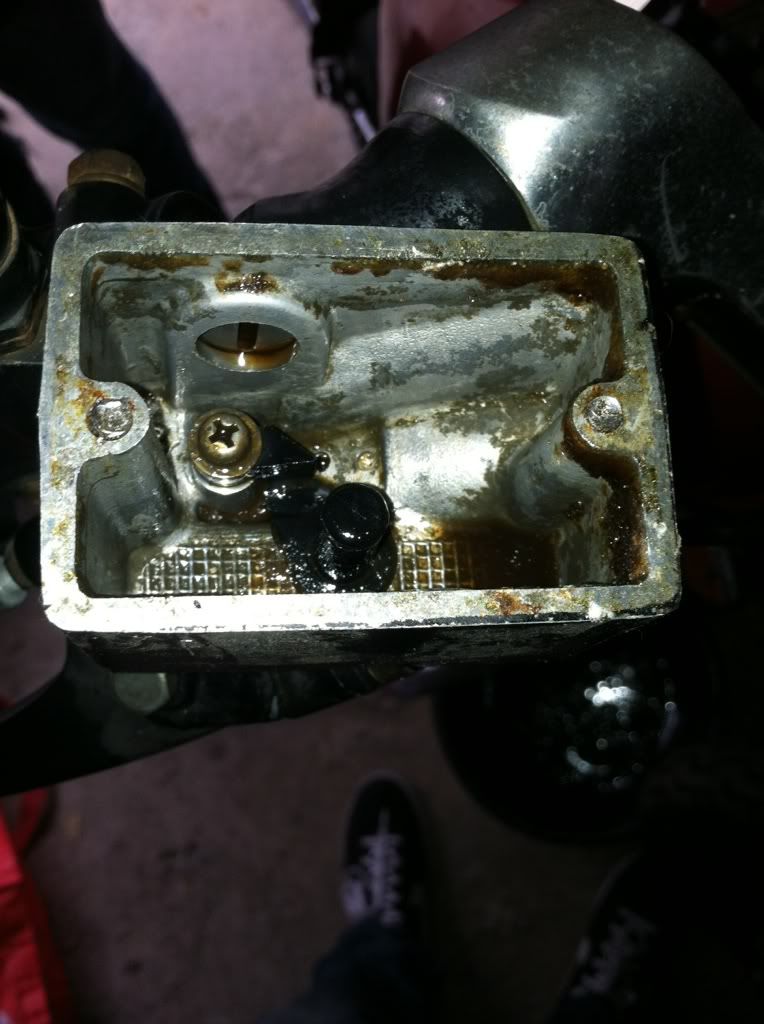

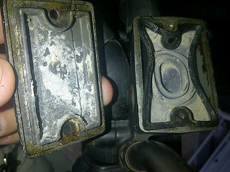

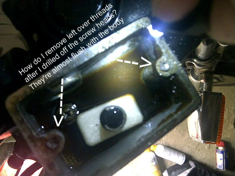

    So I took apart my brake master cylinder and I'm not sure if I should rebuild or replace it. Below are some pics of the MC so hopefully someone can tell me.
    This is cover off
    Diaphragm off (If I'm assuming correctly the name)
    Inside with no fluid
    I need to get this black piece off in order to disconnect it from the handlebars but don't know how

    The black piece is the fluid level sensor. Don't try to remove it unless you intend to replace it. I have tried and failed a few times. Just disconnect the wires from inside the headlight bucket and remove it with the master cylinder.
    You can clean and reinstall the diaphram, I woiuld say replace it, A rebuild kit is cheap insurance.

    The Old Master is salvageable.
    The Broken-off Screws are SOFT Steel and will Drill out easily.
    There's enough stock to accommodate the NEXT size Tap.
    Drill, Tap and replace the Fasteners with Stainless.
    The Holes on the Lid need to be enlarged, too.
    The Holes in the Rubber Gasket can be easily enlarges with a Leather Workers Hole Punch.

    Remove the screw that holds the sensor "arm" and then you can carefully pull the sensor out of the bottom of the m/c............there is an o-ring that seals it and it's a tight fit, though.
    The real key as to whether to rebuild or replace depends on the condition of the piston bore...........if it's pitted or rusted badly, then it's time for a new m/c. You have to look carefully at it with a strong light to see the condition. Bikes that have sat for a long time and have rarely (or never) had their brake fluid changed (the fluid absorbs water) typically will have deeply pitted piston bores which will tear up new piston seals rather quickly........

    Just create new flat grooves in the screws and use a small flathead to remove. You could use a cut off wheel on a dremmel and just be careful not to go into your MC. Liberally douse them with penetrant and screw them out. If you don't have a dremmel you could try the extractors. You might also be able to use a tiny drill bit and remove enough material that the rest will just come out-no need to re-tap.

    The idiot at Home depot told me I made up a left hand drive drill bit and when I showed him a video of someone using one he told me that it was a normal drill bit used counter clockwise. I went home with a drill bit and the extractor wouldn't bite. I ended up ruining the master cylinder and now have to buy a new one.
