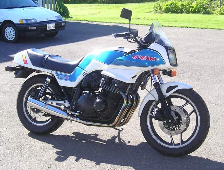

    Never seen that kind of a fairing.. Maybe it's the bottom piece of a bigger unit?

    I don't recognise that fairing, maybe a couple more pics and someone will.

    Oh- BTW, that fairing looks like a Suzuki item:
